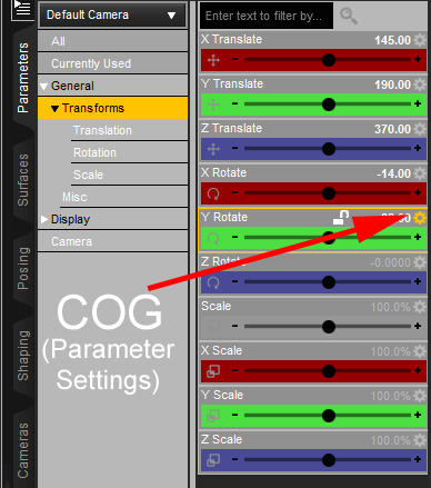

    To excede a given fixed limit of a particular node (bone etc) you need to change the parameters. This is easy. In, for example the parameters pane on our right are small Cog wheels. (See image one below)

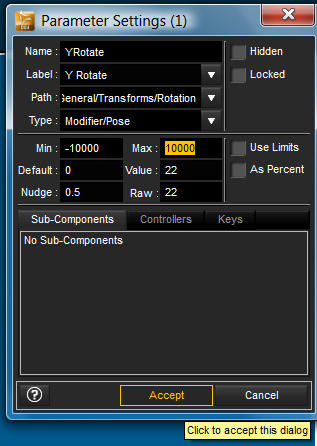

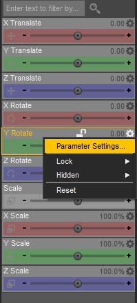

    Then chose "Parameter Settings" from the Drop down (See image two)
    Then adjust settings and hit Accept
    317 x 446 - 104K
    199 x 440 - 87K
    388 x 439 - 123K
