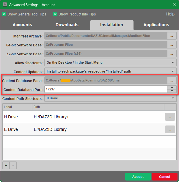

  • felisfelis Posts: 6,643
    Check the path in DIM and compare it to the path in Daz Studio. They must be the same.
  • EightiesIsEnoughEightiesIsEnough Posts: 1,271
    edited August 2025
    Are you asking the paths must be the same or the databases must be the same?
    Also, what folder should the PostgreSQL database be in? I checked C:\App Data\Roaming\DAZ 3D\cms\ContentCluster" and found nothing. Of course, I did do a system restore earlier this afternoon.
    Post edited by EightiesIsEnough on
  • The path you give above is the expected location for the PostgreSQL executable, so that looks OK. If you installed with DIM it will be listed in the installed tab, if you used a stand-alone installers it will be in the regular Windows list of Installed applications. It doesn't sound as if you lack the basic aplication, though you could check using whichever of those methods aplies, so the next question would be is it starting up. If you open Task Manager (right-click on the Task Bar) and click the More Details button then when you start Daz Studio you should see half-a-dozen entries for postgresql  in the list of Background Processes - do you?

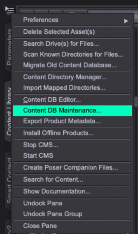

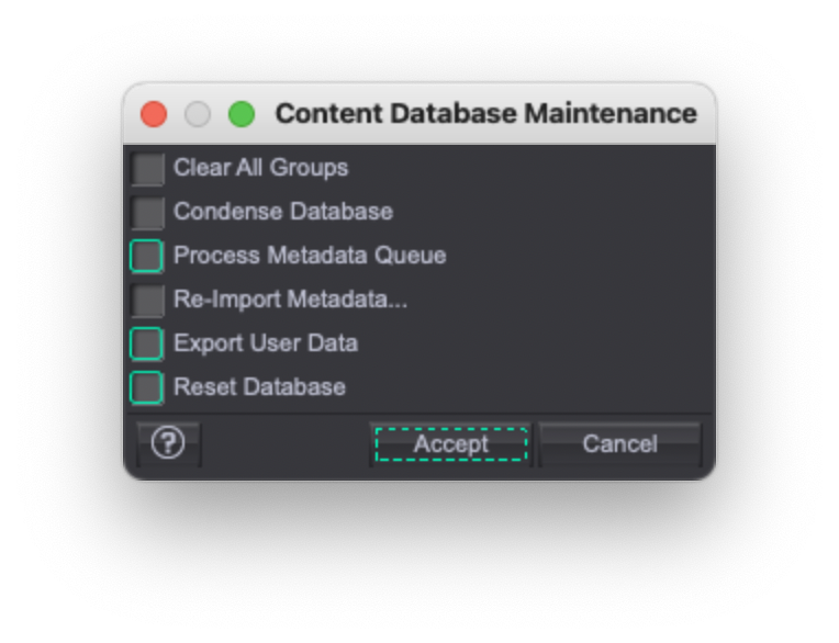

  • TotteTotte Posts: 15,283
    edited August 2025
    EightiesIsEnough said:
    How do I create an empty PostgreSQL database?
    In Studio -> Content Directory Pane (Hamburger Menu) CMS Maintainance.
    Reset Database

  • Tried it.  Still cannot connect to the database.

  • crosswindcrosswind Posts: 10,358
    edited August 2025
    As you said above, cms cluster folder locates in %appdata%\DAZ 3D\cms\. That's the default folder when it was created. If you found nothing there, you should press F2 in Daz Studio, go to CMS Settings tab, check where cluster locates (if you ever redirected the folder to other location...) and if the Port is correctly defined. Try Start / Stop postgreSQL service as well.
    Also check the settings in DIM see if DIM has connection to cms.
    And in Task Manager, can you see the session of postgreSQL Server is started ?
