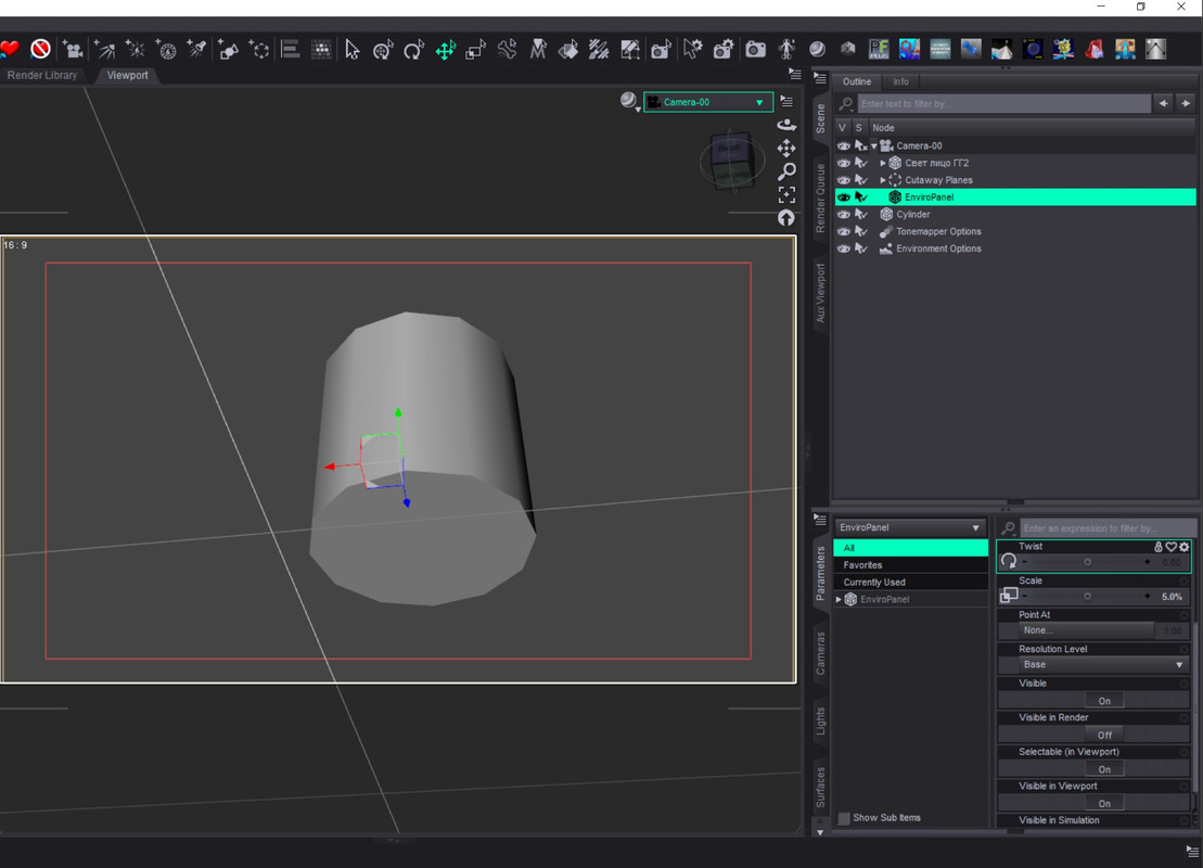

  • CES3DCES3D Posts: 262
    I believe what the OP is likely hoping for is not the display of the frame indicating the rendering area (Show Aspect Frame), but rather the display of a safety area (for example, a 90% margin for adding captions or an 80% margin considering cathode ray tube displays) in the Viewport.
    How about setting an image of the safety area (drawn in white on a black background) as the texture for the Plane Primitive's Base Color and Cutout Opacity, then adjusting the Base Color as needed, resizing and repositioning it, and parenting it to the camera?
    2560 x 1400 - 512K
