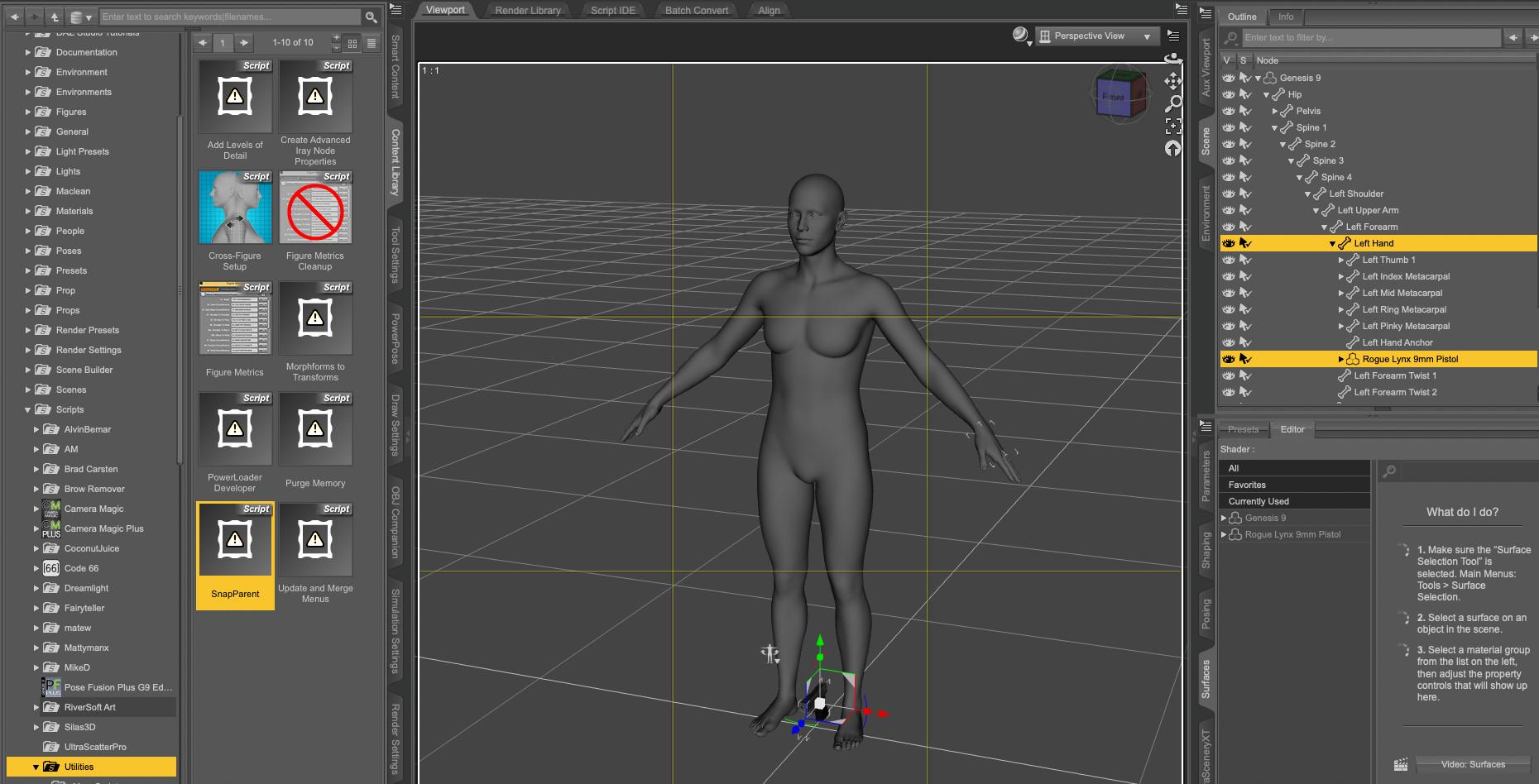

    In Scripts/Utilities, Daz is providing a script called SnapParent which will move the prop to its parent (as long as it's a bone if I'm remembering right): it will not be perfectly placed, but it'll do part of the job:
    To use it, the prop you want to move need to be parented to the correct bone, then select the bone and the prop:

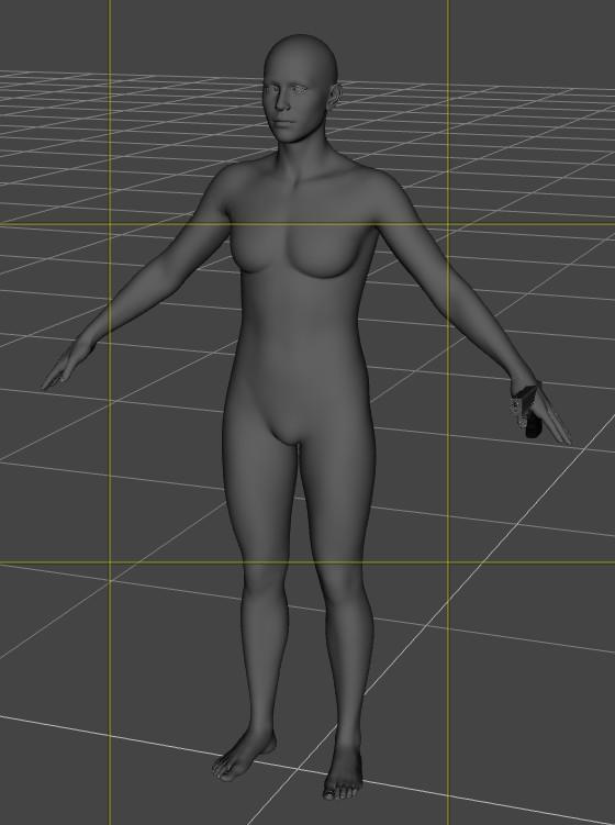

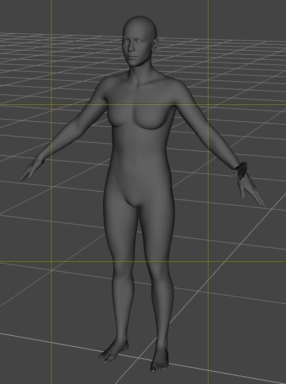

    Here I selected Left Hand and the gun, but with Genesis 9, they are 'Left/Right Hand Anchor' bones, which allows a better default positionning of the parented prop
    Parented to hand:
    Parented to anchor:
