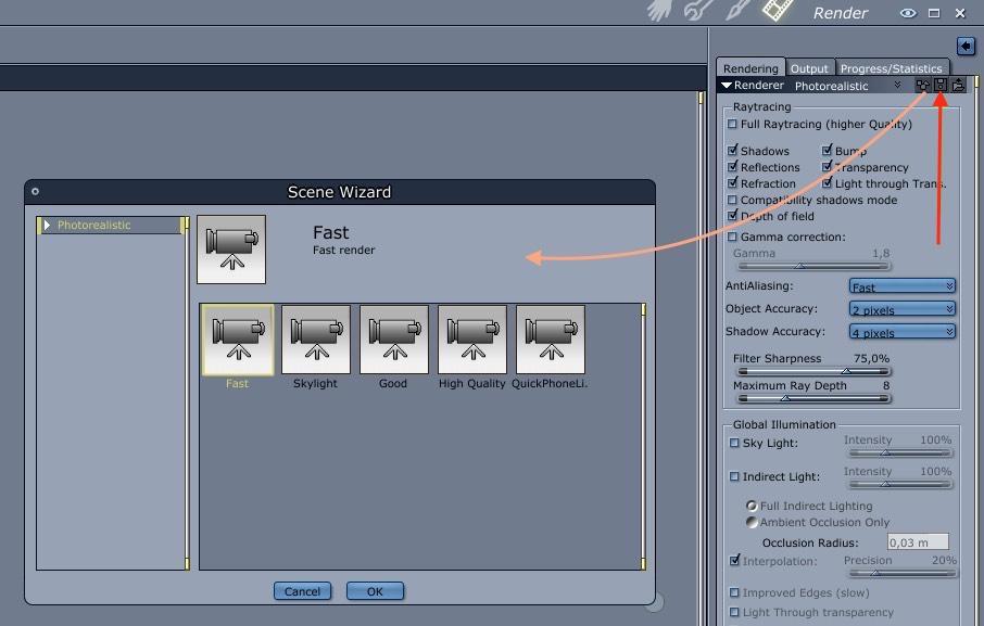

  • RuudLRuudL Posts: 227
    edited June 2025
    In the render room there is already an option for presets (orange/amber arrow). No need for a plugin or script.
    You can also make your own presets by altering the settings in the properties pane and clicking the save-icon (red arrow) to save it.

  • 3Deedlin3Deedlin Posts: 168
    Thanks RuudL. I thought there was some kind of preset. Had a vague recollection.
  • therixxtherixx Posts: 262
    Thank you, I didn't know this and sounds very useful!
