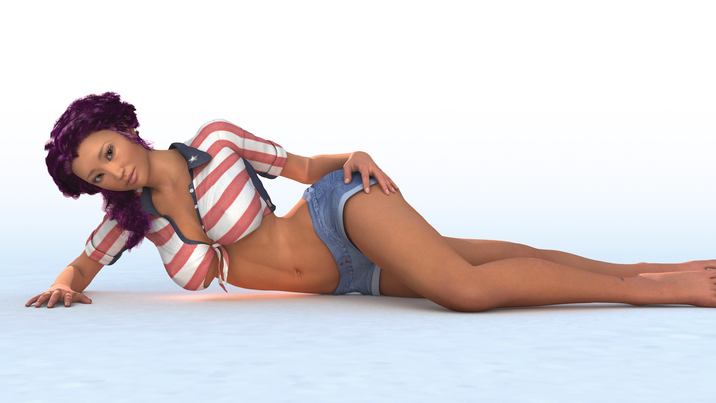

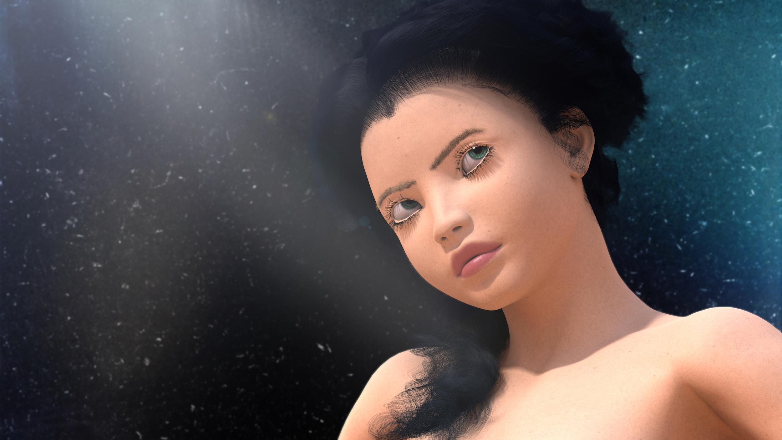

Here are a couple images I rendered with an alpha channel and added my own background and used a depth map to add a DOF in post prductions. I did not adjust levels. Both used an HDRI, the Skylight set to 150% and a key light (and in the case of A4 wearing the denim shorts, a rim light for the hair). I alsom used a low intensity elipse shape light to get the specular highlights for the eyes in the A4 shorts image. I also used full Indirect lighting set at the default 100%.
Click for full size
Click for Full Size
2500 x 1407 - 2M
2500 x 1407 - 1M
