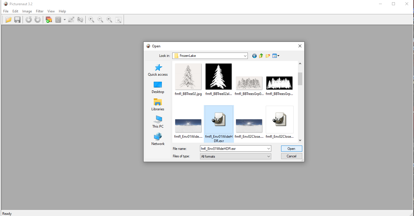

    If you don't want to use GIMP there is also Picturenaut !
    http://hdrlabs.com/picturenaut/

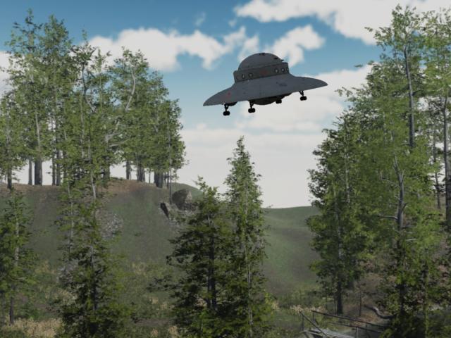

    Here is a quick test with an HDR in the JDA pack that has rural virginia.  https://www.daz3d.com/rural-virginia-hdri  Officially, it does not say that it is compatible with Carrara but it does say Iray.  I wanted to see if it could be used in C8.5.  The hdr file (not duf)  is found in the runtime\textures\\JDA HDRI\rural virginia directory.  All other light set to 0, including bulbs and scene ambient.  In render settings, sky light is checked on and gamma is set to 2.2.  Test object is a UFO in the DAZ store.
    640 x 480 - 53K

    Thanks.  I don't have indirect light checked for the UFO test.  Always more to test.
