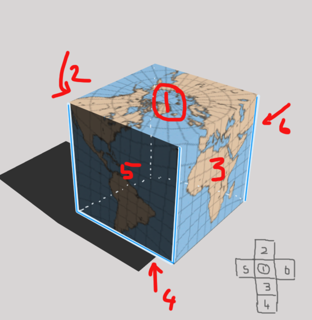

    Hi, in the thread I have started some days ago Tim posted the way to unfold a cube, here's what we had:
    This is the primary image that you need to obtain a similar effect like the above image:
    Tim (Tango Alpha) said that you needed to put seams as its follow to get the properly layout:
    And I have discovered that the 8.5 version of Carrara doo the unfold by default:
    The way I did it was to create the cube in the assembly room, convert it to "other model" as vertex object and when I selected the UV mode I could have the layout ready to UV map.

    I did read the thread. I created the cube in the vertex modeller but I then had to manually add the seams to get that cross shape - I just couldn't get Carrera to do it automatically!
    Problem is that after I 'unwrapped' the cube, I didn't know how to export to Photoshop to add graphics to different sides and then import it back into C8.5!!

    The which is great, because when I did the first try o unwrap a cube I had to separate each face and place them where the edges coincide, then Tango Alpha pointed in the way to unfold it, but now I know it can be done automatically.
    I have said before that in some cases I am following Maya tutorials to do what I want in Carrara, I did search for unwrap a cube in Maya, if you have the chance take a look to the following YouTube video, this is the way you can unfold a cube in Maya:
    Post edited by otodomus on
