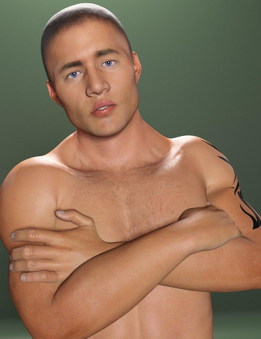

    I just posted these images of some morphs on the V4 basemesh in the "Show us Your Iray Renders" thread, but I'm going to post them here again because I'm proud of them. As Havos pointed out, The Genesis models have 1/4 as many polygons as you list since it seems you listed them after subdivision (set subD to 0 and mesh resolution to "base" to see the actual base mesh of genesis figures). The V4 model on the other hand... it has the perfect amount of polygons as far as I'm concerned. Enough that displacement mapping is not necessary, any further surface detail can be had via normal and bump mapping. The genesis models though require either displacement maps or HD morphs to get that level of realism.
    An 800,000 poly model would be a bit unwieldly to pose on today's machines unfortunately. I can import an 800,000 poly .obj into DAZ and render it, but it is noticably taxing the system and that is not even trying to rig and fit clothes and poses on it. I use zbrush every day and love it, but I'm aware that it has to pull a few tricks to sculpt on 20,000,000 polys. Riggin a figure that detailed and fitting clothing to it in a program like DAZ isn't something that has been possible yet. In the future though, I agree with you - let's get as many polys as we can. Also, I think that the whole Genesis line has too few polys for my taste, and like I mentioned before V4 and M4 hit the sweet spot right on the head with around 70,000 poly base mesh.
    Anyway, not that this compares with those hi-res sculpts you linked to on the zbrush gallery, but here is what I did tonight with V4's basemesh resolution and normal maps:

  • Not bad at all for V4 I can see the details on the shoulder, nice !

    Thanks! Yeah, the silhouette of the shoulders on the Genesis line are one of it's major weaknesses. The shoulder bends beautifully well in Genesis 3, but seen in silhouette there are only like four or five polygons over the main curve of the shoulder's silhouette - not enough to get realistic anatomical detail. V4 bends relatively poorly out of the box, but with some commercially available add-on fixes and custom fixes of my own, the V4 and M4 figures are my current favorite. Here's a comparison of the unsubdivided basemeshes for V4 and V7. V4 has about 4 times as many polys.
    WOW.... some VERY impressive work - expressions are life-like....   Kudos!!!!     - Ray

    Very impressive; I'm all for more geometry.
    Personally I think the hair should catch up with what we fave first.

    If I could create expression morphs like that, I'd go back to V4 myself. You need to write a tutorial on how you create those morphs. Any chance you could create morphs like that in Blender?

    I'm not a blender user, but I've seen that it has some sculpting functions. You should be able to make morphs with blender, but I don't know how it compares to zbrush. Once you get comfortable importing and exporting back and forth from DAZ to a modeling/sculpting program to make your own morphs you'll want to do it all the time to fix wonky joint bends and clothing fits etc.
    One thing that I've found is that having 3D scans of real people to use for reference for anatomical detail has really helped. For example, I can see that the way V4's arm bends looks wrong, but don't have the anatomical knowledge stored in my brain to see how to fix it. A 3D scan of a figure of similar body shape with her arm in the pose tells me what I need to know, and with the scan next to V4 for reference I make the fix to V4 and save it as an arm bend fix morph for later use.
    Linvanchene, one thing to take into consideration is that rendering a 20,000,000 poly scene is not the same thing as posing a rigged 20,000,000 poly basemesh . It would be painfully slow to work with the figures at full resolution in DAZ. You can try it by turning on HD morphs and boosting the subdivision of a Genesis figure to subD 4 - not the final render subD which only comes into play at render time, but the live posing subD. You'll have to go into the top subD slider's preferences to remove the limit on subD levels available, I think it tops out at subD 2 by default. Be warned that raising it to 4 has a very good chance of freezing your computer and crashing DAZ. When rendering, DAZ can only handle that many polys because it's putting everything else on hold and using all system resources to do it with nothing available to compute bend morphs and collisions etc. That kind of shifting of resources isn't available while working on a live scene though, which is why there are two different subD modes available - a low one for posing and a higher one for rendering.
    I think a 100,000 to 200,000 poly basemesh for Genesis 5 would be a winner though, a good compromise. The face in particular could use the extra detail and more facial polys wouldn't cause joint bending issues, plus it's already on a separate UV map so it doesn't need to have the same resolution as the body. If V4 has 70,000 polys and people were using her in 2006, I think it could be stepped up a notch for today's machines, rather than down (heck, V3 had even MORE polys than V4). It's useful having the Genesis figures available for background characters, but they look a bit rubbery and toony without HD morphs (which we users aren't allowed to make) or displacement maps (which have many practical usability limitations compared to morphs).
    Does anyone know why DAZ decided to make the Genesis line with such a lower polycount than the earlier figures? Is it to simplify weight mapping and clothes autofitting? Or to make them usable in video games?
    I do totally agree with you Linvanchene that a higher res basemesh is desirable - I'd be very happy with a 100,000 poly figure until our computers are powerful enough to play with even bigger ones.

    While I like the face, IMO the arm resembles more of an orange peel with exaggerated bumps. It doesn't even look aged, as the skin isn't looser- it's just raised and some of it is not elongated into more wrinkled / loose pores but the raised part seems too much. The face and chest look quite respectable though!
