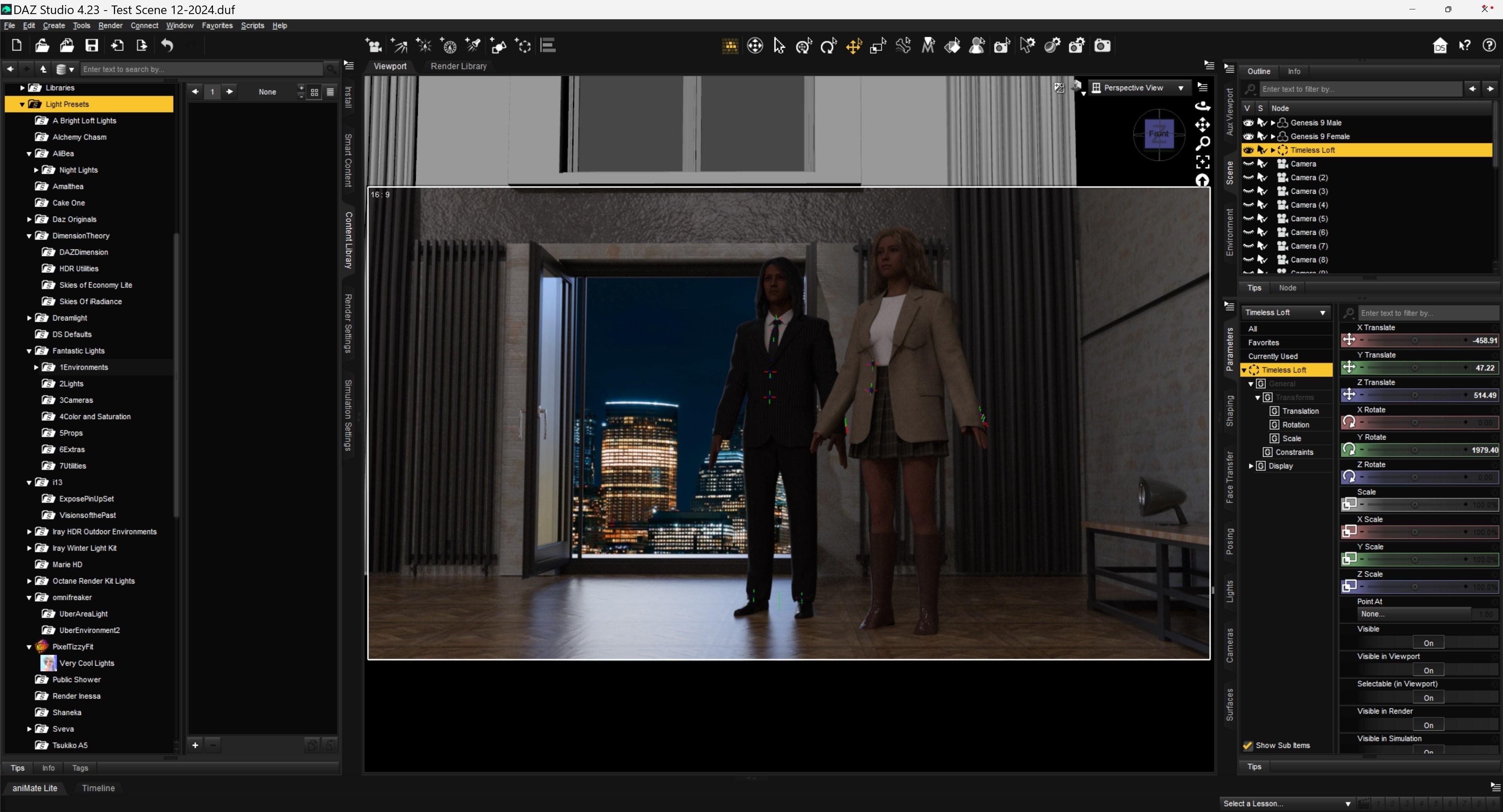

I want to lighten the scene, I am not sure how to do it properly
Halcon BlueskyHalcon Bluesky Posts: 727
edited December 2024 in New Users
Hello Crosswind or anyone else.
Here is the problem I have.
I am using this Environment https://www.daz3d.com/timeless-loft
My characters do not look well, I wanted to increase the lighting output to 6500K with no luck
In the screenshot you can see how bad is the scene, (Not the one I am working, but this one is almost similar in look)
I tried to put a lamp closer to the people, nothing works.
I have some lights at the Left pane, I don't know which one can do a proper job.
Please guide me, I have a project I need to finish.
I have tried other environments with Windows (does not matter if that is closed or open windows) the lighting is causing me some headaches I can't get the best result out of that.
Thanks beforehand for your help.

  • If doing the rendering process, the final image will look a bit dark.
    I want to look crisp for the final output when printing the final image

    Well, my friend, some settings in this product are not properly set... I suggest some quick tweakings as below:
    1) in Render Settings, set Env. Mode to Dome and Scene (default is Dome Only so interior is pretty dark)
    2) Add some lights as you wish. I just used two spotlights in the below example.
    3) set value 2 in cm^2 Factor in Tone Mapping
    The settings should also work for a night scene...

    What type of lights I can use?
    I had tried some that reflect the lighting to the window, this gives me a bad impression something is not right.

  • crosswindcrosswind Posts: 10,253
    I most of time just use Spotlights but it's up to your preferences.... Better avoid the lights being reflected on specular surfaces by tweaking the lights' postions, or you can use ghost lights if there're too many specular surfaces in the scene. But this scene is simple...

  • FishtalesFishtales Posts: 6,232
    Have you turned the Emissive settings on for the bulbs in the scene. Looking at the features there is a .duf file included to do that.
    The file for the lights should be in the folder for the Timeless Loft. Just double clicking on it should turn on the lights in the scene. If not then go to the scene tab, select the lights, go to the surface tab, select the lights and scroll down to the Emissive slider and change the colour to white which will turn on the lights, it also opens the light settings which can be adjusted if needed. You might need to render the scene to see the lit scene properly as using the Iray option in the viewport sometimes doesn't show the lights in all their glory :)

    You don't have to ... but that could be an option since you don't have other tools. However, using D-Former or dForce will be cumbersome even if you know the techniques. Well, I made two morphs for you by using Blender which is much easier. Pls download the attached file and extract the data folder to your Daz Library where you installed the product. Reload the jacket and dial them as per the screenshot 1. These morphs should've been made by the vendor ~~ devil
    As for the emissive lights. All the emissive lights on the ceiling are all on, however, they are pretty far from the location where your characters stay...though they have pretty high Lumen. I still suggest you use 2-points or 3-points spotlights which'll be easier and give you good effect. The light is shown in screenshot 2... alternatively you can load a couple of them (or with instances) into the scene, and hang them on the ceiling of the 1st floor if you'd like to...

  • ChezjuanChezjuan Posts: 547
    You can go to Tonemapper options and lower the exposure value to bring up all the lighting.
