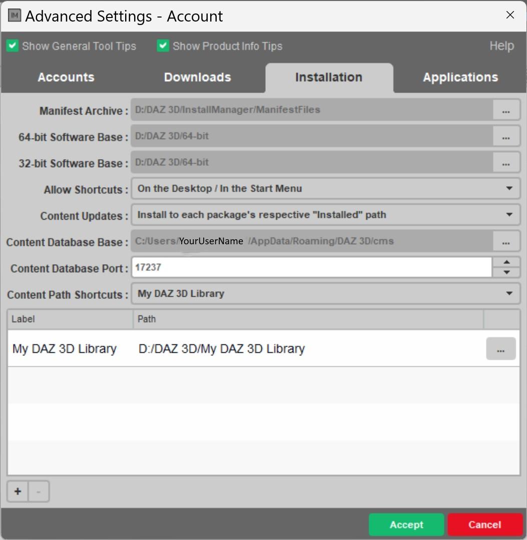

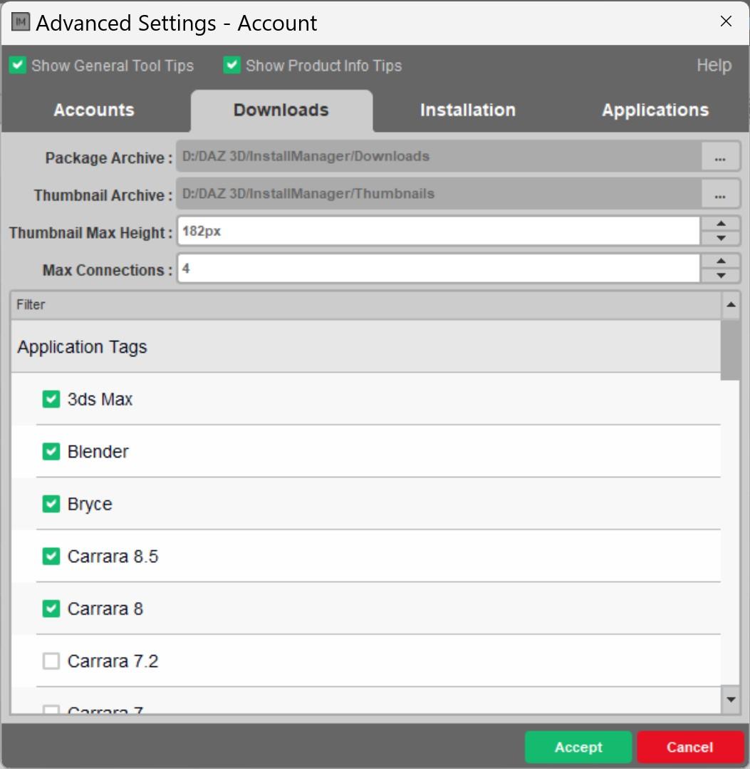

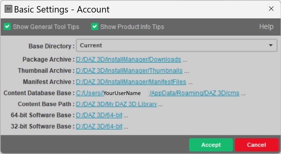

  • Halcon BlueskyHalcon Bluesky Posts: 756
    edited October 2024
    MJW The SSD is your main disk in your computer, isn't?
    Then you need to add a secondary internal drive in your computer.
    The capacity can be as much as you need.
    Then you need to copy the installmanager folder into that drive.
    Save the documents that are of importance to you into an external disk.
    you must disconnect the secondary drive from the motherboard, to avoid problems when re-installing Windows, you can reconnect that later
    When done, you can erase/reformat the SSD drive and do a clean install.
    After that, install all the applications that you used.
    Daz 3D must be installed into Drive D.
    For that purpose you must install DIM first and then run.
    Change the install to D:\Daz 3D
    The installmanager folder must go to D:\Daz 3D
    The Manifest folder must be empty
    These parameters must be changed in DIM to work prperly
    There is no need to go online, DIM will take care of the installation, the only thing is that it will take some time to complete the install.
    I give you an idea how is my install scenario
    Good luck

    The manifests are .dsx files which contain information. Potentially there are actually two of them for each product - one lives in the folder with the downloads and provides information about what is in the zip, the other lives in the manifests folder and is a recod of excatly what Install Manager did when installing the product. If the instalaltion manifest is missing then DIM will assume the product is not installed.
    You can use a text edittor to search-and-replace the isntalaltion paths in the manifests, but although that isn't hard I would not recommend it. Another option, if you kept the zips, is to update the isntallation path then seelct everything in the Installed tab, right-click on one, and use the Reinstall using current paths option.

    Thank you Halcon Bluesky. This is the sort of guide for an idiot I needed. I take it that your D: drive (I already have one) could be any letter i choose which is not already allocated? How might I split things over more than one drive, as a large enough one for everything might bankrupt me?
    Yes, the drive letter used doesn't matter. If you use an external drive make sure you explicitly assign it a letter that won't change though, otherwise you will need to update the settings each time the letter changes.
    You can only have one folder for package archive (where the downloaded zips go) and manifest archive in the "downloads" settings, and one install path for each application in the "applications" settings.  They don't all need to be on the same drive. The package archive is the one which may take lots of space, especially if you want to keep a backup of the zip after installation, so put it on a big drive. DS application itself and manifest archive don't take much space, so they could remain on C drive if you want.
    You can declare several content paths to install your content in "installation" settings, you'd then have several entries in the table at the bottom of the tab. For example in my DIM settings I have the default one on C drive, and one on a big external drive.
    If you declare several of them, you'll have a list where you can choose which install path to use for the next batch of installs in the main DIM window.
    You will also need to update DS preferences to tell it that there's DS content in all those locations, so it can find what you installed.
    Post edited by Leana on

    Thanks. That may be working. When it says 'delete package after loading' is that the zips or something else, please? Given the time to download them I am loath to have to do it all again. I see the package files in the expansion window, but the drive is not indicated.
    Yes, the package is the zip that is downloaded - without it you won't be able to reinstall, and it provides insurance against the times when you can't get online or when downloads are very slow.
