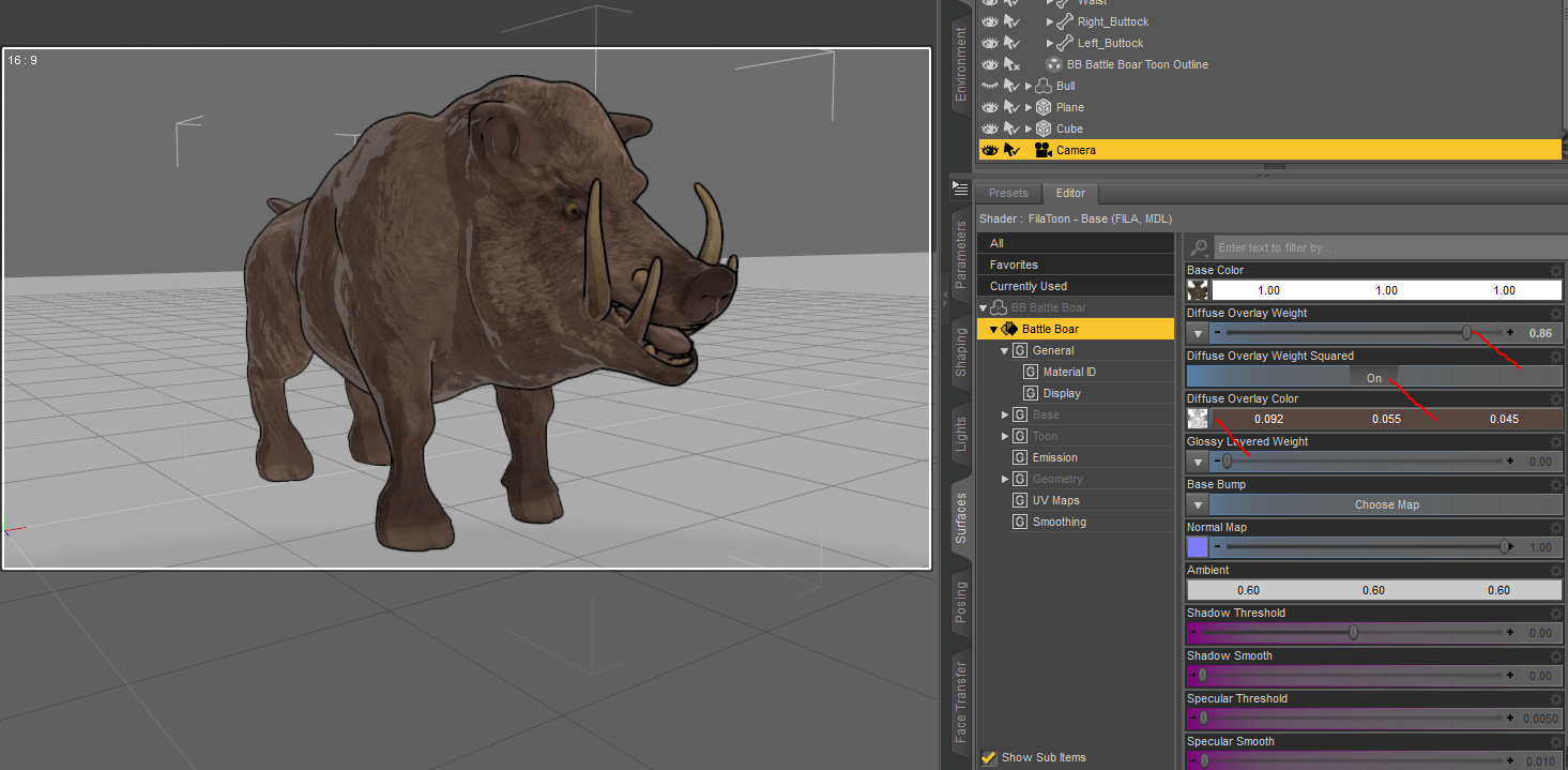

Am playing with the Filatoon shader now, and I found that for some of those heavier and darker textures, you can use the diffuse overlay color & texture slot to improve blending with the toon shader.
Here I applied the toon shader to the Battle Boar and kept the original textures, which were too dark/heavy. Then I turned up Diffuse Overlay Weight, enabled Diffuse Overlay Weight Squared (I don't know what that does but it looks better), set a Diffuse Overlay Color and applied the Battle Boar Roughness Map to the Diffuse Overlay Color texture slot. (The roughness map texture is greyscale, so it adds extra detail without affecting color.) It's not perfect, but it gives a lot more control without going into an image editor to manually adjust textures. Also increased the offset distance from 0.1 to 1.0 on the BB Battle Boar Toon Outline in the hierarchy to strengthen the outline.
1465 x 719 - 541K

  • where do i find outline in hierarchy?
    Cam Fox said:
    I don't know if this topic warrants its own thread! But I was noticing tips and tricks buried in the Q&A thread as people are also using that to get installation help, etc.
