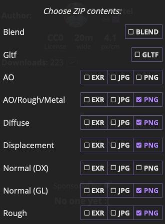

    You can download a version with just the various textures images.
    Click on the Blender logo and chose Zip, then chose the images you need (make sure you get Normal (GL) and not Normal (DX), from what I remember, Daz use Open GL normal map):
    You will have then to place each image in the correct place in the surface.
    Off the top of my head, Diffuse goes to Base color, Roughness goes to Glossy Roughness, Normal to Normal, Displacement to Displacement and I'm not sur you need AO/Rough/Metal but as far as I remember, you don't need AO (to be sure, just wait for a wiser head to confirm or deny what I just said :)) and it should look like this:
    You can get PNG pictures for textures that need to be very sharp or if storage space is not concern or get jpg if storage space is a concern and if JPG artifacts won't be a problem (which is usually most of the time except when the textures is about very sharp lines).
