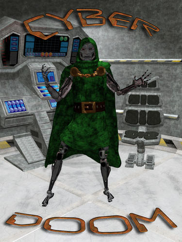

  • edited September 2012
    I had a lot of fun playing with this guy today. It's definitely the type of character I tend to enjoy. :) A larger version is over at DeviantArt: http://fav.me/d5dkmwd
    400 x 533 - 101K

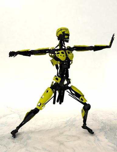

    BCRice, thank you for the quick answer.
    Just bought the CyberM4 and did my first Carrara render of him, looks ok for a 5 minute job, but some of the leg pistons got detached...
    /Edit Could not resist, added another pose, some pistons are loose again..
    DzFire, could you explain once more what sort of bugs the attached file above will help with?
    500 x 650 - 98K
    500 x 650 - 129K
    Post edited by 3drendero on
  • DzFireDzFire Posts: 1,473
    You zeroed the figure. When that happens, it turns off the point at function for the pistons. Zero pose shouldn't have that affect. You'll need to save your pose, delete the figure and reload the figure and pose. ;)
