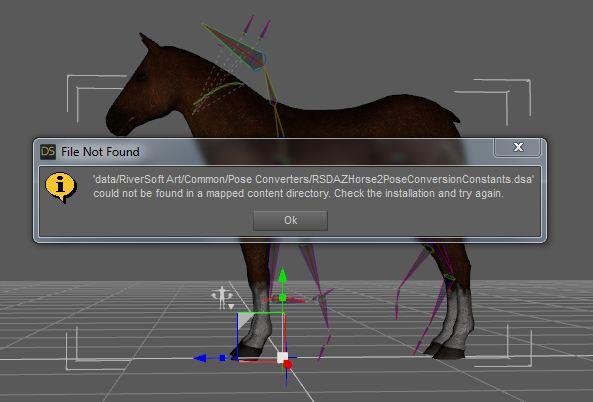

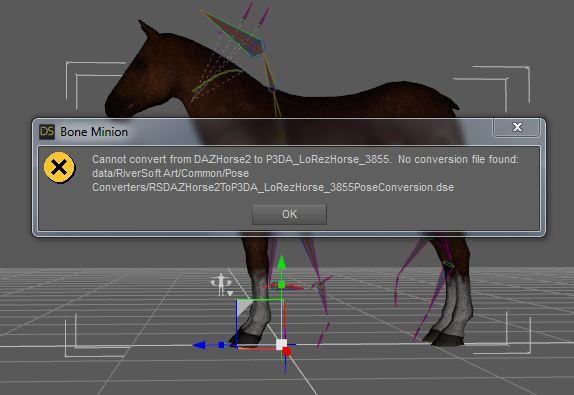

    I've got a problem which noone else seems to be getting.
    I installed the Horse Bone Minion using DIM. I loaded a Lorez horse and added the Horse 2 bone minion. I get error messages about missing files. (The same thing happens with a Horse 3 also, but these screenshots were with Lorez horse).
    Attachment 1 shows a missing file error for a constants file. I went to where DIM said this file should be and it has a different name. I copied to the name the error message is showing and got past that step.
    Attachment 2 shows the next error message (after I copied the first file). Again the file installed through DIM has a different name. Copying the .dse file to the name the message shows gets me through that error and the whole thing works fine.
    Attachment 3 shows the files that were actually installed. How have I got the wrong file names when people in earlier posts are apparently using it without problems?

  • RiverSoft ArtRiverSoft Art Posts: 6,968
    edited August 2024
    ETA: By the way the ReadMe file list (part attached) shows the names that I have, so why is something looking for a longer file name?
    It looks like it is not finding the DazHorse2Metadata.dsa file (the metadata files are what tells the script the abbreviations, e.g., DH2).  Is E:\Daz Data\Daz Studio Master Content\Base Animals one of the directories listed in the Daz Studio Formats section of the Content Directory Manager?

  • MelanieLMelanieL Posts: 7,867
    RiverSoft Art said:
    Yes, that directory is listed in CDM under Daz Formats. I will take a look at that DazHorse2Metadata.dsa file and check that it contains something sensible-looking re abbreviations.
    The only other thing I can think of is that I have other Bone Minion sets installed in a different directory (I keep my People and my Animals in separate ones) - could this be having any effect?
    I plan to switch my desktop PC a little later today, so I'll try removing the "People" directory temporarily and see what happens.
    edited August 2024
    OK, so I'm apparently the oddity for having multiple content directories! Apparently multiple Minions in different libraries just don't play friendly with each other.
    I moved "Base Animals" to the top of the CDM hierarchy and it worked fine. So I reinstalled the Bone Minion for Horse 2 Poses into the "People" directory where my other Bone Minions reside and moved my CDM setup back to how I want it.
    All is now well - here's a quick screenshot of a Gen9 on the Lorez Horse 2 using a pose for Genesis (M5) on Daz Horse 2.
    Thanks to both Riversoft Art and barbult for taking the time to look. I'm so happy to have my Minions working: I love them, they are such helpful products.
    That makes sense.  The find just looks for the first directory that matches.  Your other bone minions have a Pose Converters directory but it was empty of the horse stuff.  You could have just moved those files over to your first one in your directory list.
