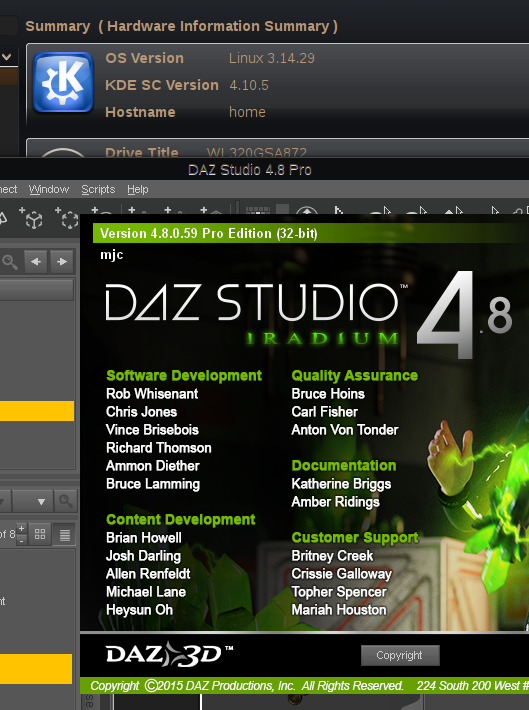

Of course running in Linux through WINE, I can do as many versions as I want side by side...just create a new 'prefix' for each one (it's like a separate install of Windows...each has its own registry/appdata)....
But that again, is 'unsupported'...
Taozen, who were you rendering? I don't have my Gen3M loaded yet (I am starting from scratch on my new computer and cataloging as I go, customizing content. In 4.8 of course, as 4.9 scrambled it!) and I can test those three if I have the hair, clothing, figures. I can do it on 4.8 and 4.9
You were able to get studio running in linux?
'nuff said....

I'm SO jealous. Have not had success getting DS to run in Linux, yet. Still working on it.
I'm waiting on a new hard drive to try and get the 64 bit version working...
Ah, didn't notice the 32 bit there. The 64 bit is the one I'm trying to get working currently.
