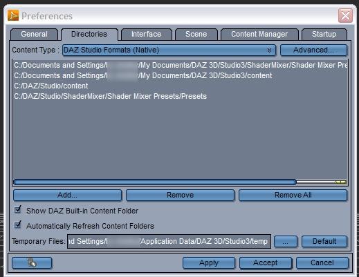

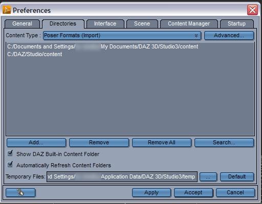

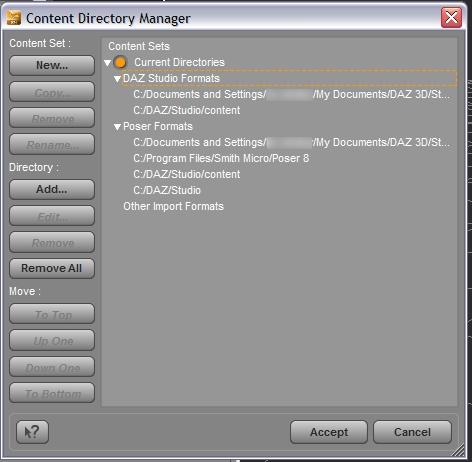

    OK here are the screenshots in order
    S3A Daz Content
    S3A Poser Content
    S3A Other Content
    S4 Daz/Poser Content

  • fixmypcmikefixmypcmike Posts: 19,719
    edited September 2012
    In your first screenshot the first DS-format content folder is the Shader Mixer scenes folder. That's where the data files are being saved, and that folder is not listed in DS4.
    ETA: You also have both DAZ\Studio\Content and DAZ\Studio listed under Poser formats in DS4, which isn't the cause of the data file problem, but it could be causing other problems.

  • JaderailJaderail Posts: 0
    EDIT: MIKE (OPPS, I said richard) is correct. Your data files are in the Shader folder for DS3. Needs listed in DS4 as a DS folder.

  • kyoto kidkyoto kid Posts: 42,403
    ...OK added the folder but still getting the same results.
    Here is a SS of the content manager screen.
    720 x 452 - 91K

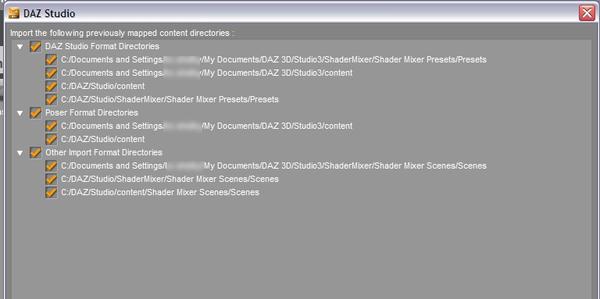

    That's not the directory you have listed in your screenshot of the DS3 content folders. Try going to the Content Library tab, options menu, I can't recall exactly what the option is, something like "Import Mapped Content Folders".
    ...here is an SS of the Mapped Content Directories.
    768 x 383 - 82K

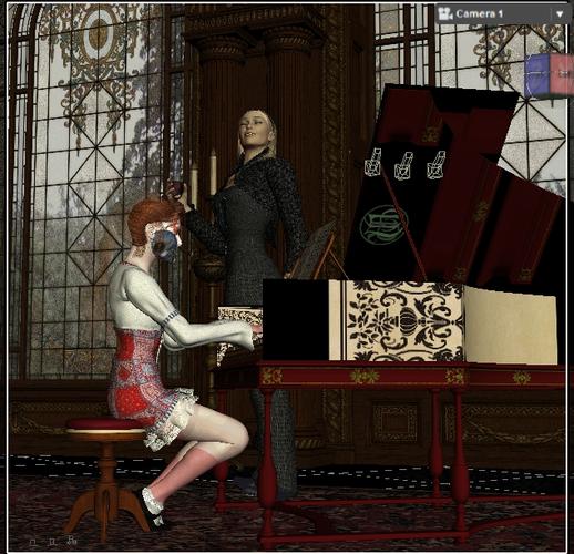

    ..OK seems this is the right setup as all the scene elements finally loaded.
    However...
    Some of the shaders are totally bollixed up.
    So it looks like we're kind of "home".
    Thank you for the help at least I can finally access scenes creates in 3A. Now all I have to do is figure out this shader mess.
    634 x 612 - 339K
    ...OK when I got home I restarted S4.0 and reopened the scene, While the harpsichord textures loaded correctly this time, the MATs for Leela did not.
    When I originally created the Leela character I used the full figure MAT from Jamminwolf's Tindra Thompson as it gave her the appropriate freckled skin texture I needed. However, for some reason Studio4 apparently doesn't seem to like it, or for that matter, even the default Steph4 MATs as they load incorrectly too.
    This isn't good for I thought as long as I am using Gen4 characters instead of Gen4 Body shapes for Genesis, whatever MATs were originally designed for the figures should still work without having to make any adjustments..
    I zeroed the MAT, chose a standard V4 texture, and that loaded fine. I then went back and loaded the Tindra MAT, only to have it apply incorrectly again.
