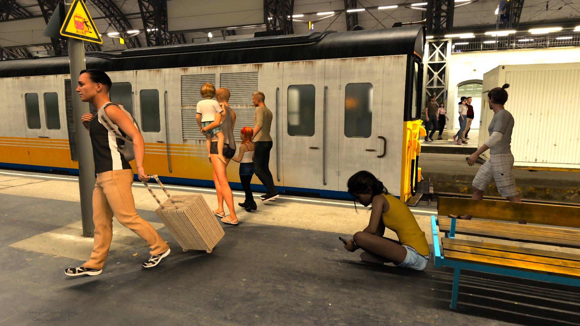

     Why? I used Dresden Station HDR in this old render. I also have others using HDR's.
    1920 x 1080 - 355K
    Post edited by Fishtales on

    Three years ago. Hopefully I have moved on a bit since then :) Fair enough though If you can't spend the time to get them to work. I am retired so have all day most days to jump in and out of Daz Studio, not everyone has that luxury :)
