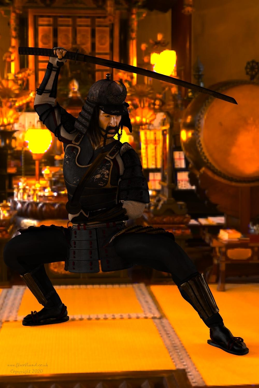

I've been using HDRIs for skies, distant scenery, and abstract portrait backgrounds.
Now I've bought Prometheus and I'm struggling to make those HDRIs work for me.
The light is beautiful and the shots look (mostly) good as long as I don't show the feet:
Zoom out and my character is awkwardly floating above the scenery:
Experimenting with "Finite Box with Ground" and other such settings.
Now my character is standing but the scenery is distorted:
So... what am I missing?

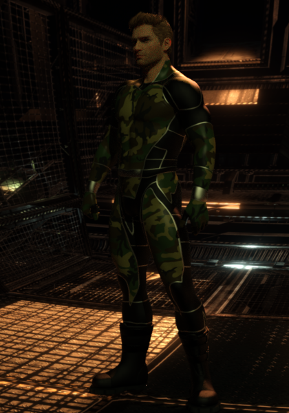

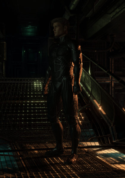

These promos from Spaceship Interiors manage to do it:
420 x 600 - 313K
420 x 600 - 304K
420 x 600 - 318K
Post edited by Hylas on

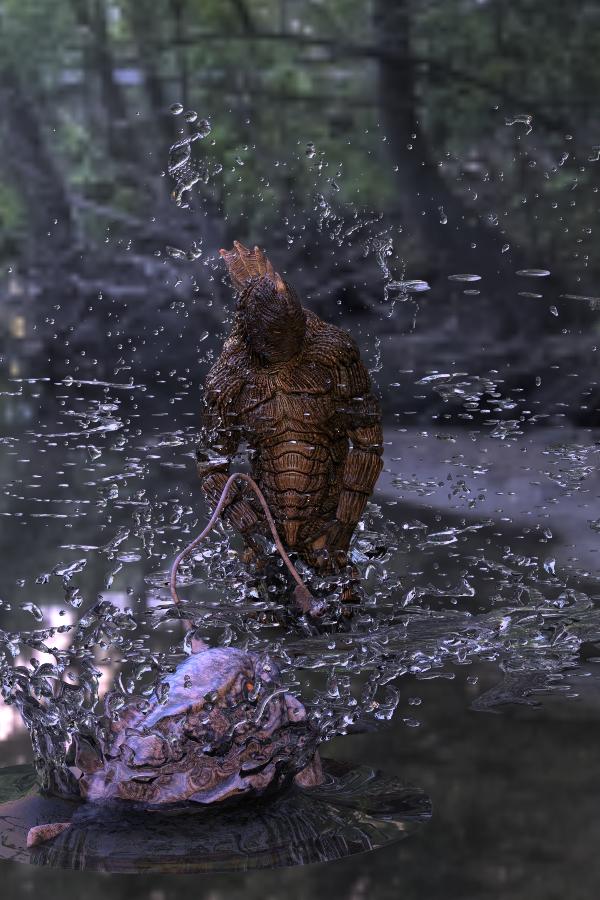

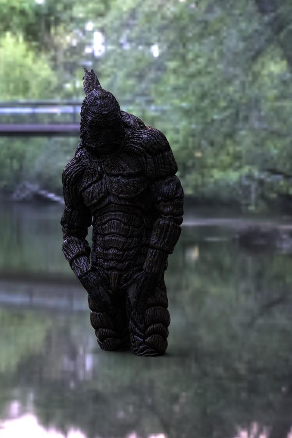

    Change ground from Auto to Manual and move the character down. You can even make them stand 'in' water this way.
    600 x 900 - 270K
    600 x 900 - 436K
    Post edited by Fishtales on
  • HylasHylas Posts: 5,344
    @dtrscbrutal: Thanks, will look into that!
    @Catherine3678ab: LOL, the robo voice is endlessly distracting. If V3 could talk, that's what she'd sound like laugh anyway, watching it now.
    @fishtales: Thanks for the input! That's not the issue I'm dealing with, though. Ground position is already "manual" and my figure is standing on the ground. If I move them further down they'd indeed sink into the scenery and I don't want that. I just want them to stand on the floor!
  • FishtalesFishtales Posts: 6,233
    The other things to watch for is Camera Angle, Zoom, Height/Position and Focal Length all of which can change how the asset works with a HDRI.
    edited June 2021
    Ok, so here´s some progress:
    Character needs to be at X=0, Z=0
    The soles of their feet need to be planted on Y=0
    Ground Position Mode = Manual
    Dome Mode = Finite Sphere
    Dome Origin Y needs to be Dome Scale Multiplier x100
    Dome Scale Multiplier is 100 by default, so set Dome Origin Y to 10'000
    Now your character possibly looks like a giant or dwarf, and the backdrop is possibly distorted.
    Adjust Ground Texture Scale and Dome Scale Multiplier until you get a better result.
    (Each time you change Dome Scale Multiplier you have to re-adjust Dome Origin Y to it's new value x100)
    Above example is Prometheus 6
    Dome Scale Multiplier = 15
    Dome Origin Y = 1500
    Ground Texture Scale = 190
    Still more distortion than I'd like...
    I wish there was a way to "squash" or "stretch" the finite sphere, I think that would help with the distortion.
    Will keep trying things, input by experts welcome.
    edited June 2021
    It took me a long time to get these two to work :)
    Click on image for full size.
    1000 x 1500 - 716K
    1000 x 1500 - 808K

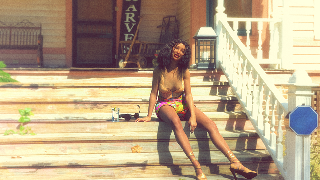

    Yeah, I found I wasn't able to make poses on the ramp in the OPs example HDRI look good from any angle when the feet are in frame (which is a shame because the lighting is great at that rotation), and it seems to be because the ramp nearly at the center of the map. When one crops out the feet though, things start to look okay. I will say, some of the HDRIs in this pack look okay with the ground included, and in fact the HDRI in the OP does look okay with feet in frame with the right rotation of the map. I've attached an example with camera centered, Y = 151 with x/y rotation and focal length to center the character in frame, and ground set to manual. I will say though, while the positioning looks natural to me, the HDRI seems too low res for this kind of use. I'm actually considering returning it now.
    844 x 1500 - 541K
