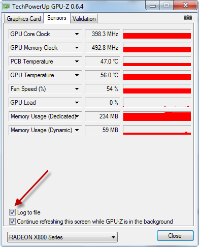

    The first thing to check is whether your card heat sink is still doing it's job. So download gpu-Z here, install it and fire it up and check your fan speed which shouldn't be at 0 and your gpu temp
    You can log the monitoring to a file so that you can check the log later
    According to Nvidia the GT 430 max temperature is 98°C but I doubt it should go so high.
    If the fan is the problem then you can change it for a few bucks

    Did as Takeo.Kensei suggested. The program says my fan is running at 52% and my temperature is 39C. Too bad, the fan would have been a lot cheaper to replace than the entire card.

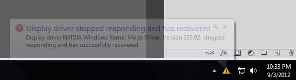

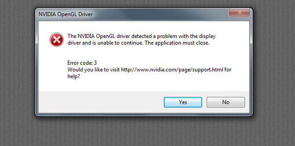

    Okay, just had another crash (this time Photoshop was the victim). Here are two screenshots of the errors I'm getting. The windows error (which I almost didn't screenshot in time) pops up first. A few seconds later the next error message pops up and that's when the program crashes. I've searched Google like crazy but can't seem to find an answer for this. I hope someone can make sense of this!

    If it has only started since you updated the drivers then I'd suggest rolling back to the previous driver version (you could try this anyway, newer isn't always better) and judging by the screenshot of the error message it looks like its the driver rather than the card itself.
    It would seem that the OpenGL driver and the nVidia drivers aren't working together all that well and is causing a conflict which is causing the driver itself to crash and causing the symptoms you're experiencing.

    I was doing some trouble shooting for a error code at work today on one of our servers and i seen this artical on code 3 errors and i thought of this thread i seen this morning, its give a brief description of what causes the error and few cues how to resolve it.
    I hope it helps good luck
    http://www.almuseo.com/nvidia-error-code-3.php
