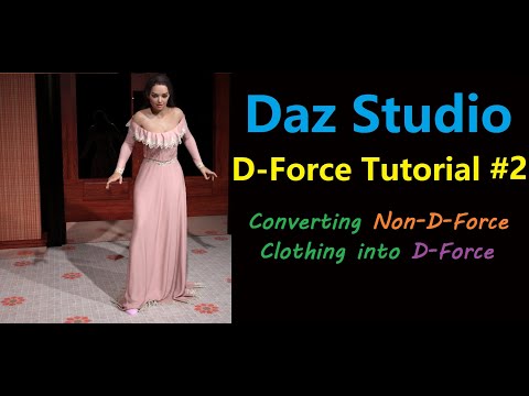

    I don't have the product you're speaking about and I have yet to try doing it (but I'm planning on trying it myself) but theorically, it should be possible.
    IThey are likely other videos, but these two are the ones I watched recently and hopefully, they may help you: the first one explain a parameter to change to reduce the risk of explosion, the second goes a bit further by explaining how to paint a dForce weight map, which will (if my understanding is correct) help you to decide which part will be simulated and which part will stay mostly in place.

    Some great suggestions, thank you very much. Elor, the vid links are a great assistance to help re-inforce the written word. Richard, I had read about these wieght maps and un-welded cloth, which I believe was very common in older clothing items. I had intended to exclude the metal. I was also thinking I would need to do something to stop the pants flling straight down, so they keep a little stiffness but collide with other objects, like when sitting. Although that does also need the time line animation to move the two items together during the simulation. I was thinking to not include the trim on the pants to help them drape away from the legs. I wasn't thinking of adding dforce to the vest as it does drape well and for most poses doesn't cause me concern. Chris, thanks for your input. I like that you don't think converting between generations should cause any issues.
