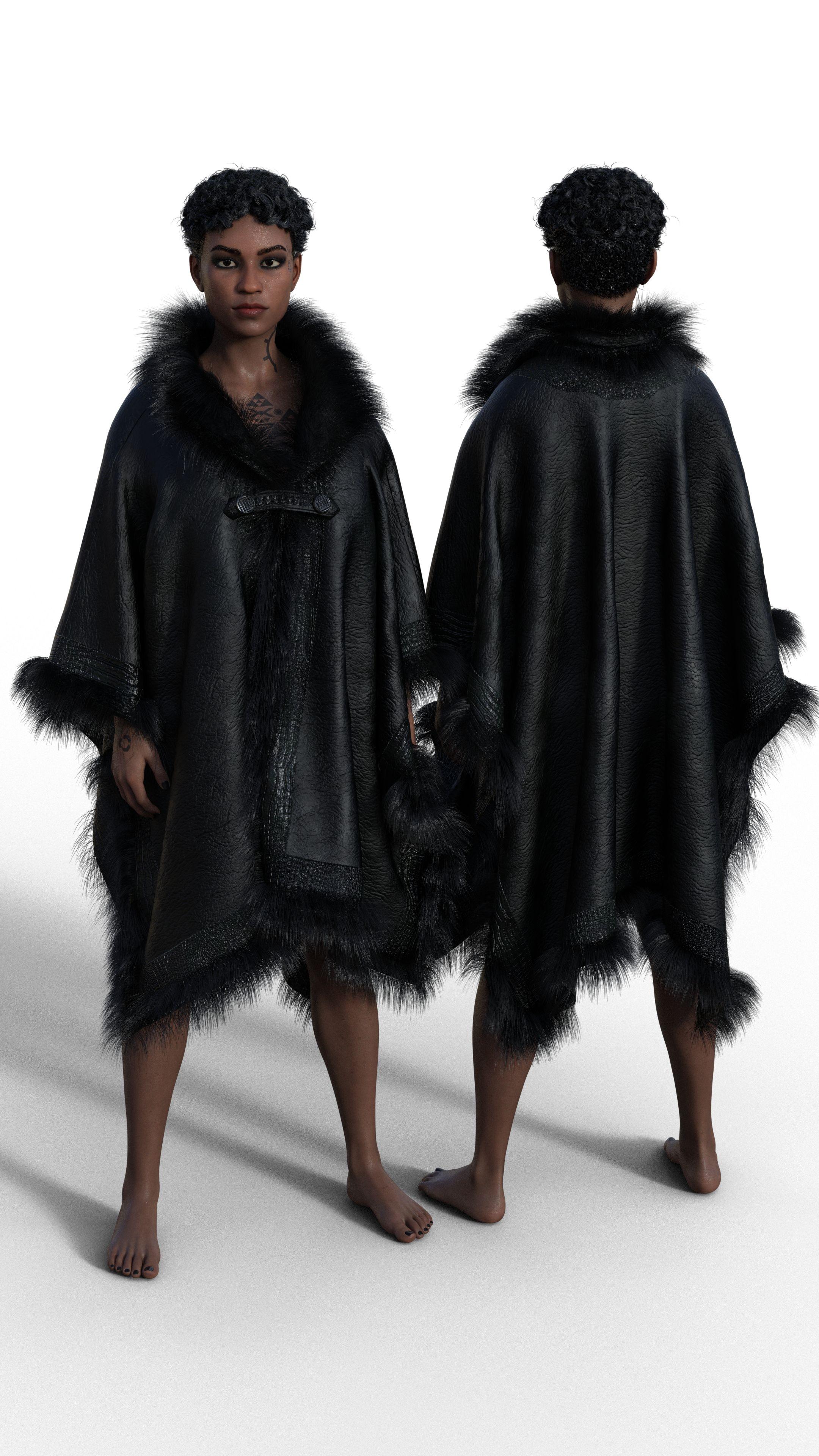

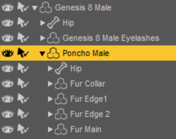

    This is the correct setup: Select the poncho in the Scene Tab, now click on the fur you want to load.
    The result in the Scene tab should look like this:
    The render should look liike this:

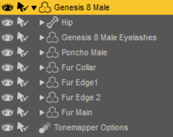

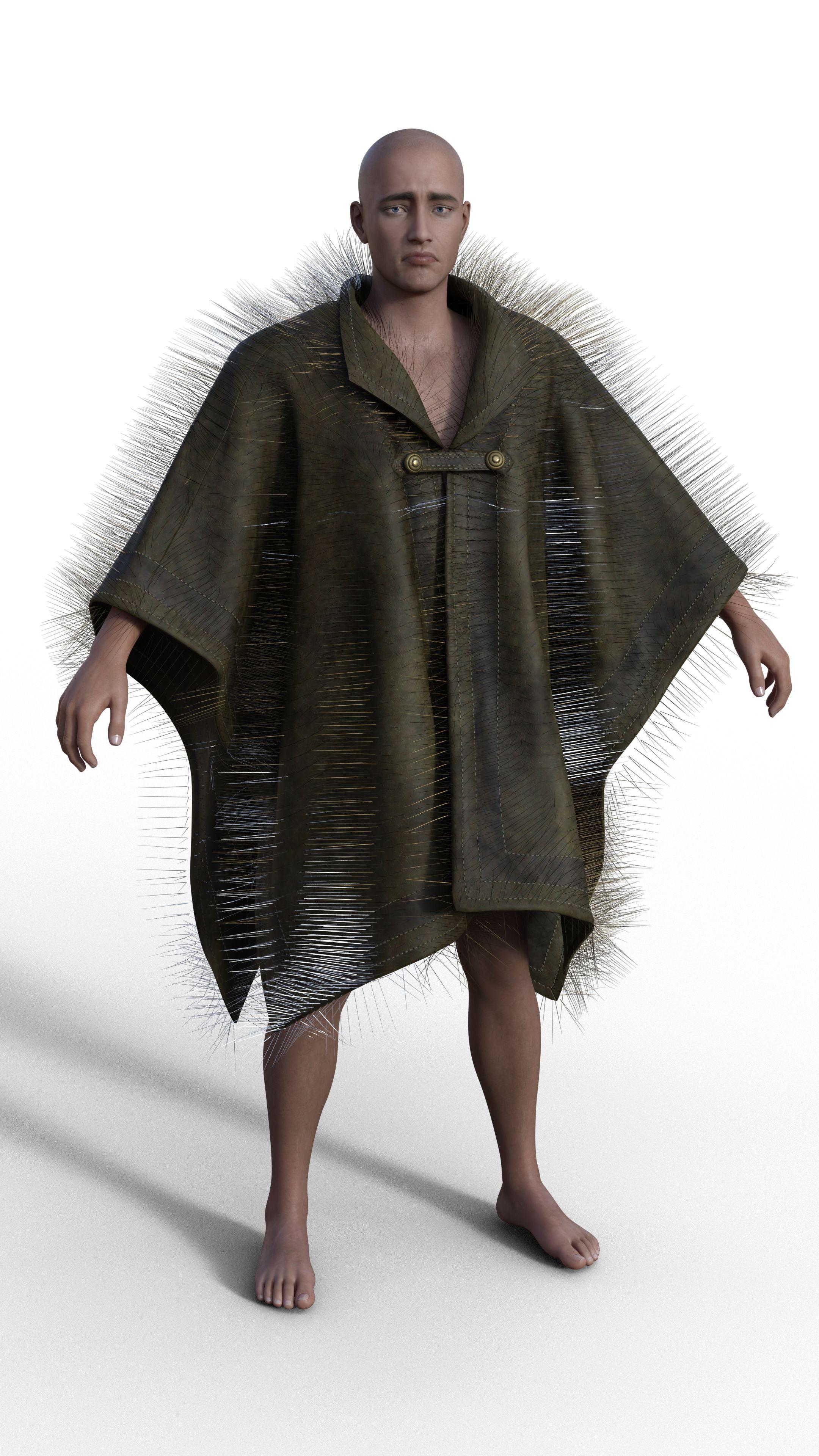

    If you have the figure selected when loading the fur it looks like this in the scene tab:
    And the render looks like this:
