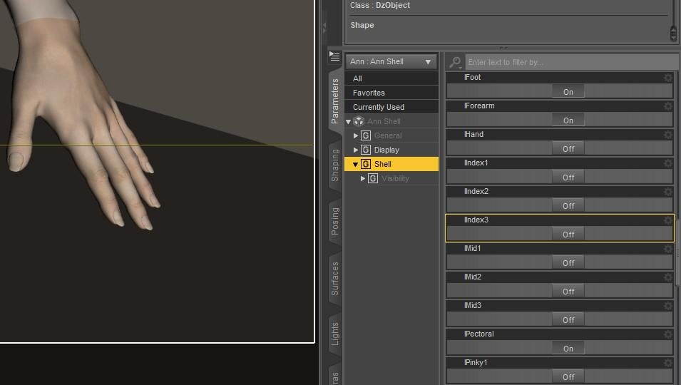

    The visibility of parts of the geoshell can be controlled in the Parameters pane. Visibility can be turned off by Face Group as well as by Surface. Just select the face groups making up the hand (and fingers if you wish) to make it invisible.

    Post edited by barbult on
