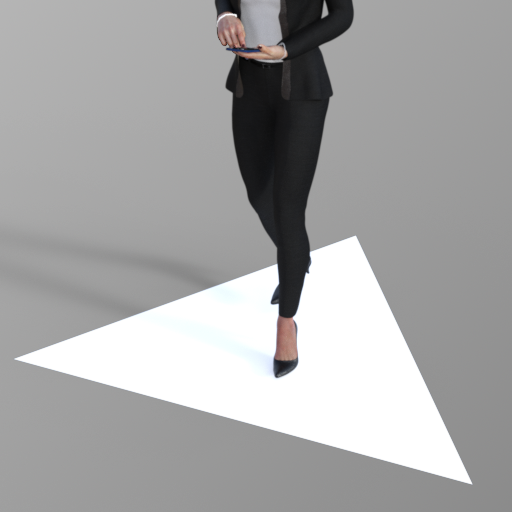

    Just for the fun, I spent a little while creating a morphing triangle prop. The apex of the triangle (behind the character) can be moved in X and Z. The movement is 1cm = 1% morph at 100% scale. Morph "Corner X Movement" = +/-86.6% to make the triangle into a rightangle triangle. Yep, I know the number is horrible, but with an eqilateral triangle, some numbers always will be. The triangle is UV mapped from above, scene X axis the image horizontal axis, though no texture is included. The texture will distort as the triangle apex moves.
    Anyway, please find below a Floor Triangle prop library item with two morphs, tex mapping, a duf file, .duf.png and .tip.png & data files. I cannot imagine it's possible to have a prop with fewer than the 1 facet and 3 vertices this prop has...
    I hope it's worth the effort!
    512 x 512 - 208K
