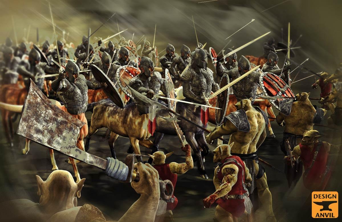

  • Design Anvil - Razor42Design Anvil - Razor42 Posts: 1,250
    edited December 2015
    There's a number of ways to accomplish larger groups, but I often found multiple renders in group sections and then compositing gave me the results I was happiest with.
    1200 x 778 - 163K
    Post edited by Design Anvil - Razor42 on
    Impressive scene!
