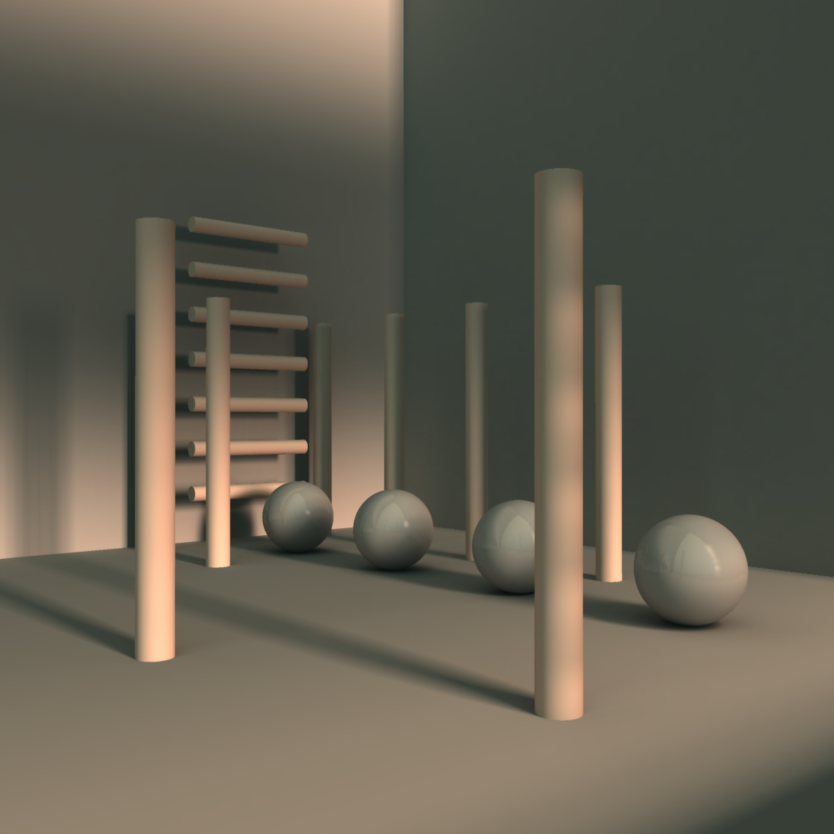

is there only the soft shadow option or is there a setting to get actual area shadows?

Hi,
Have you tried using a light array?
In Carrara, use "Replicator" to create an array (grid, box etc) of point lights.
Or,
In example pic, I used a "Surface replicator" to create array of point lights on plane.

Sure, Attached.
Forum does not allow .car files, so have had to zip the file.
