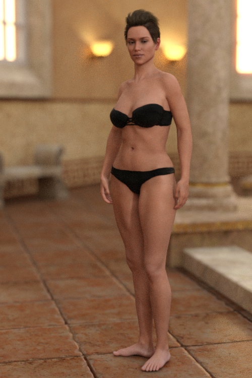

  • Gr00vusGr00vus Posts: 372
    edited December 2015
    That set has a lot of windows in it. It looks like they're using an HDRI for global lighting "outside" (given the clouds you can see outside I figure they're rendering the dome with the HDRI in it, otherwise it could just be sun/sky) - the windows are letting a decent amount of that light in.
    The interior has a bunch of lights on the walls. Seems like they might be using IES profiles in those. Maybe just simple emissive objects, or spots, but for your purposes IES profiles will do the job simply and effectively.
    So that probably accounts for much of the "ambient" lighting in the set.
    Then, as timmins.william said, it's highly likely they're using one or more "off camera" lights focused at the model herself too for some of those shots.
    In others, like this one: 09-daz3d_olympia-7_.jpg it seems like they're just relying on the "ambient" light set up to take care of things.

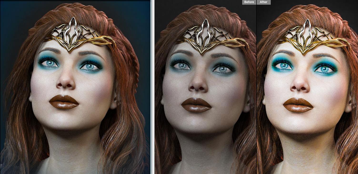

    There is a lot you can do in the rendering, but you can also do a lot afterward.  The image shows my original render in the center.  The one on the left is my changes in Photoshop using levels, unsharp, a few other things.  I have been learning about Camera Raw in Photoshop.  While it's meant to take advantage of the large range of information in a raw shot, it will still work with other formats including jpg.  You would want to work with a large image and lit as well as possible.  The image at the right is after working in Camera Raw.
