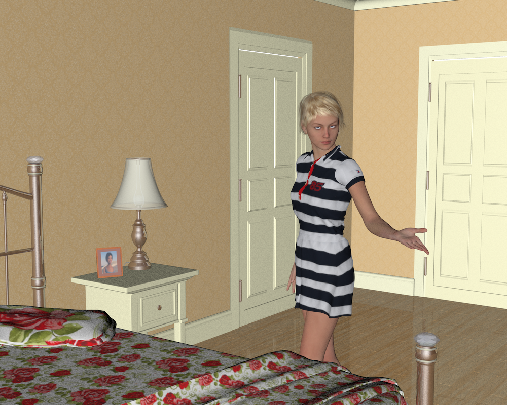

  • Thanks!  It took the attached scene just over an hour with a single area light applied. The scene I'm currently rendering has anothe figure in it an the lights are brighter but it's taking so much longer - I'm at 8% after 2 hours and 20 minutes. Can brighter lights make it take that much longer?
    Thanks for your help!

    Go to the Area Light and post the light parameters for it (if/when it  finishes...).
    There are usually other settings on area lights that can pump up the render times.
    Also, what is the skin shader on the additional figure?
    What's the render size?
  • Thanks - relly stupid question when you say go to the area light - how do I do that?
    The render size is 800 x 800.  The skin shader on both figures are each generic Genesis 2 shaders.
    The attachment above is supposed to be darker - she's in a dark room.
