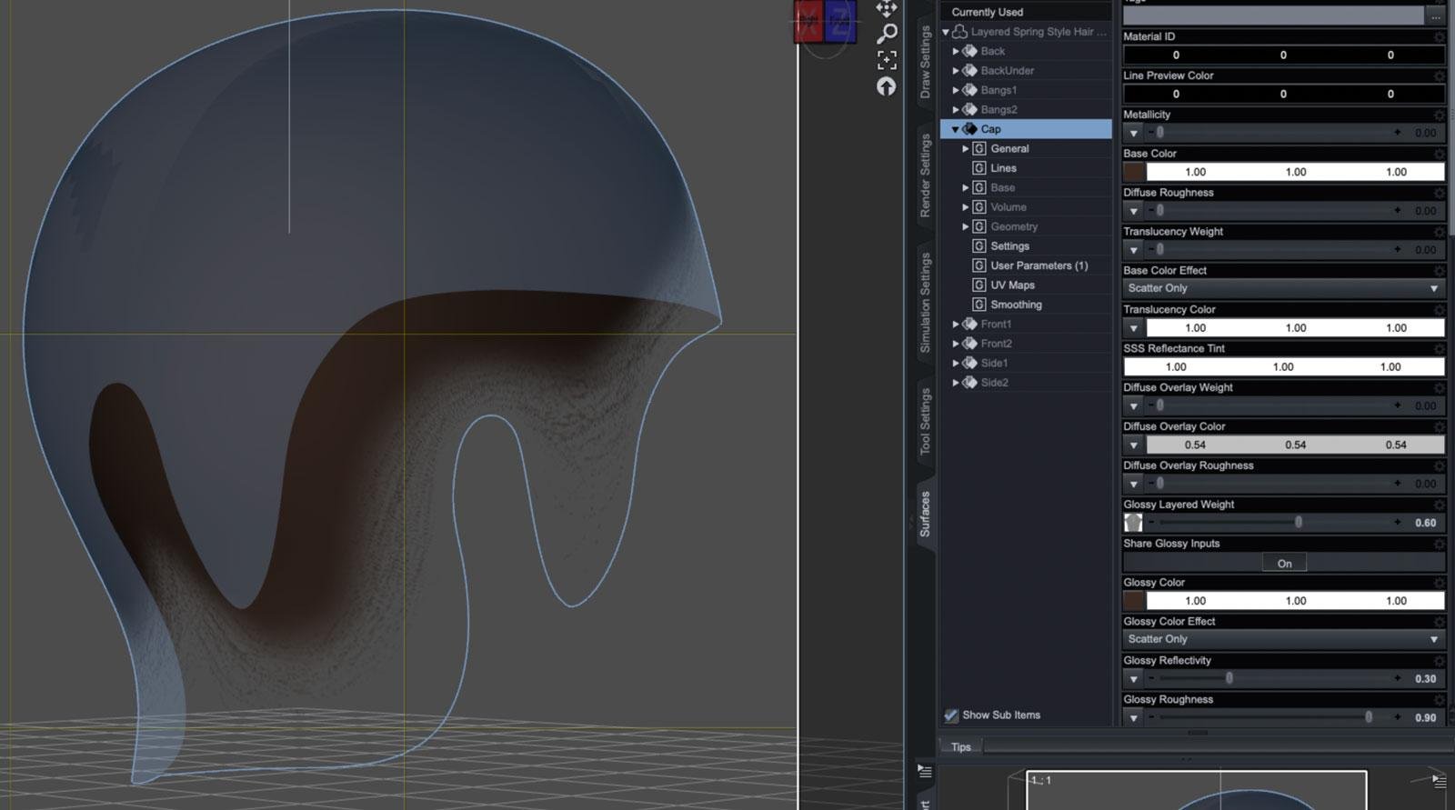

    Thank you for your suggestion @SofaCitizen - this hair does not have any scalp to increase or decrease - see attached pic

  • SofaCitizenSofaCitizen Posts: 2,185
    edited February 2024
    Ahh, in that instance the scalp is part of the same object (Cap surface) and so you would apply the slight increase/decrease to the entire hair if you still wanted to try that method to fix it. Although if you already found a different way then perhaps not needed this time.
    Thank you once more @SofaCitizen - what do I change under the Surfaces> Cap to decrease or increase?
    Ahh, the surface image was just to show that it has a mesh surface that would be the part that appears to be intersecting with your characters forehead. You would need to adjust the size of the hair as a whole. I can see that those controls are hidden so you first need to show hidden controls using the corner menu.
