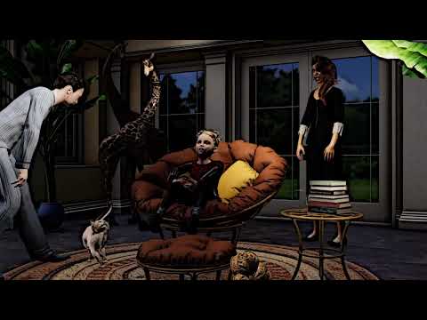

video test using Filament and Gimp Cartoon filter
sadly the cutout opacity flicker is rather distracting
