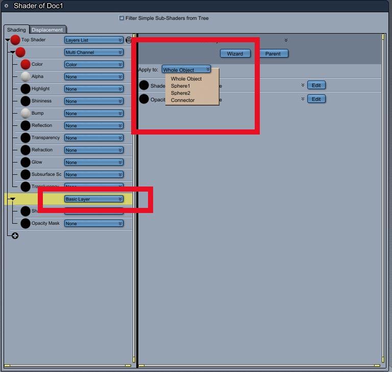

    You need to set it at the level of the parametric shader for each layer - it won't let you change it at the top level. My screenshot shows a basic layer, but it's the same with the parametric one.  I have no idea why the dropdowns only populate at the lower levels, just one of Carrara's delightful quirks. laugh
    Layer List - Basic Layer Options
    768 x 730 - 53K
    Post edited by MarkIsSleepy on

    Interesting - I was about to post that they will still not appear in the top level because it didn't work for TangoAlpha and has not worked for me in the past, but your certainty made me try it again and suddenly it works. Now I have no idea why it didn't work for TangoAlpha above. He said he has more than one shading domain set up on the object, but if you look at his first screenshot, the drop-down is not populated with the names of the shading domains he created.
    My problem was that the dropdowns were not populated at any level, so there was no way to assign a shader to the domain. After a night's sleep, I opened the project this morning, and all the dropdowns were now populated. AT EVERY LEVEL!
    So the solution it seems, is save and reopen the project. Maybe this is a Mac issue?
    I've tried building one of these shaders several times in the past, but because the list boxes didn't populate, I just threw it away and went back to the old staple of creating separate master shaders. This was the first time I saved it, shut down Carrara and reopened it later.
    Anyhow, thanks guys, MDO2010, McGuiver, Diomede smiley
  • YofielYofiel Posts: 204
    edited November 2015
    the object with the layers must be selected in the preview window for the layers to show up. There is a drop-down list in the top left corner of the preview window if it is showing a plane or globe instead.
    Seems to do the trick - thanks :)
