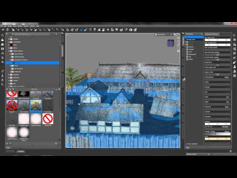

    What fog shader are you using?

    Uber Volume.

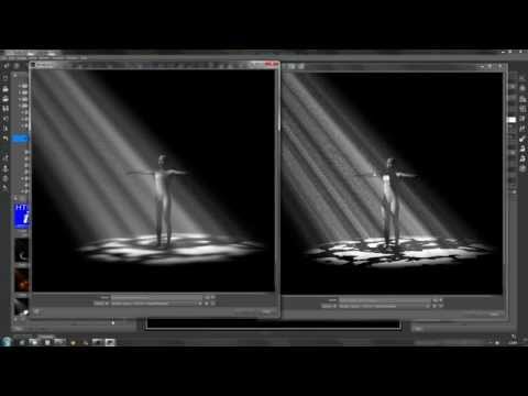

    I also have AoA's atmospheric camera, but the render times on THAT are obscene; better off adding godrays in post or something.

    Uber Volume is very slow...

    Yes...AoA one is somewhat faster...and you can whip a fairly simple fog in ShaderMixer (I'll see if I can find an example network) that's a bit faster, too.
    There's other ones that are faster, but require working in ShaderBuilder and/or the stand alone 3DL.

    I like the look of the fog from this product: http://www.daz3d.com/above-the-fog-for-iray-and-3delight. It takes a different approach to volume fog shaders, but I think a number of the promos do look pretty good. As you can see it is for iRay and 3DL. Mostly useful where you want to see visible thick fog, rather than the thin haze created by volume fog that blurs distant objects.
