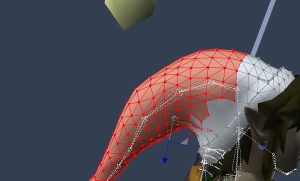

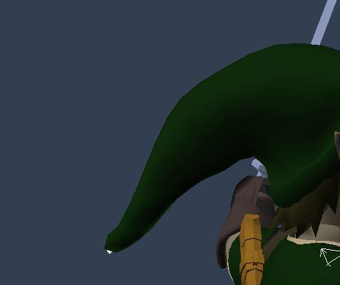

    See this hat I want it to be floppy like cloth I tried rigging it with bones it doesn't work the way I want.
    I want the selected to be mainly the soft body.

    Basically I want it to interact with everything like a piece of cloth would do without falling off his head the same with most of his other cloth. I would like his clothes to interact with the environment with out having to make a movie of it. I want it to collide with my model, interact with everything it bumps, I want the clothes to have different settings. My model has a thick hat on it should act like a thick hat, he has chain mail on it should act heavy. He has other objects attach to him. I just want more realism I can't help, but have yearning for that which is natural, and should somehow exist within this program, and I know at least 50 percent should be possible by now. I just don't know how to do it after the model is rigged.
