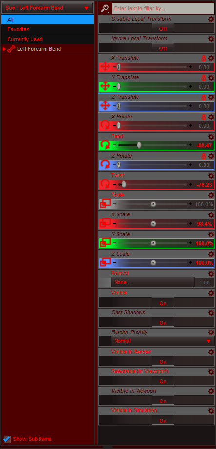

Hi, I attach some images, the right forearm of my girl is making this disgusting problems, I did try different reset functions but I can't find out why this does happen...
I don't want to delete the char and delete a new one.
Left arm:
(problematic) right arm:
other problems see attached images.
What is going on? I can't find the error.

  • LoonyLoony Posts: 1,817
    Update:
    https://www.daz3d.com/forums/discussion/comment/7241236/#Comment_7241236
    (I just googled Daz3D bending) and found that.
    Here we can now see, it's not where it should be... how is that possible? Does some derps add bone movements when they make pose presets?...
    That's how it should look.
    901 x 872 - 31K
    897 x 846 - 33K

    I've had this happen and the cause has been unwanted JCMs from other characters getting dialled in when they shouldn't.
    In your parameters tab turn on Show Hidden Properties and then look in the Currently Used section. Scan though all of those properties and you may find joint correction morphs for one or more other characters you have installed are active. Zero them out for a quick fix. Ultimately the offending character(s) will have to be fixed either by yourself or by raising a ticket at the marketplace you bought it from.
    If it is this and you want to fix it yourself, post again and I or someone else will be able to tell you how to do it should you not already know. I think you're pushing your luck with these images so this reply may disappear with your post!
    (Edit - you added the skeletal problem just as I replied! In Joint Editor right click in the scene view, Edit -> Adjust Rigging to Shape but make sure the character is in its base pose when you do this.)

    Hi, it's the bone inside the arm, I could not find any active JCM related to the arms.
    TimberWolf said:
    See above :) Set the rigging to shape.
    I made it a bit more complicated xD...
    I loaded a new G8F copied the Shape and did copy the values from the bone to my positoned char^^...
    See attachment, I think... that should now be correct :)
