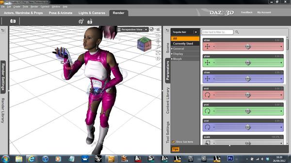

I am having a problem with the hair on my models, when I put the hair on them everything all right until I put a pose on the model then the hair just stays in its original position and not moving with the model. I have clicked on the hair and went into parameters but there is not option in there to (( FIT TO V4 )) for the hair?

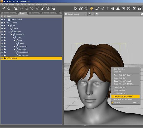

That's a Prop hair you need to parent it. Open the Scene Tab, Expand your figure so you can see the Head listed , now just select the hair in the scene tab and drag it to the head, it should list right under head in the list. Or select the hair in the viewport Right click and select Change Parent select Head from the list. Be aware that Head maybe listed twice you need the one connected to the neck.
If if does not 'Fit To' v4, then, once you have it in the position that you want it in, you have to 'Parent' the hair to the model. You can do this by right clicking on the Hair in the viewport ,a selecting the parnet, or by dragging the hair in the Scene tab, and dropping it on the Head of V4 also in the Scene tab.
The example shown is the right click menu with Genesis, but it works the same on all figures.

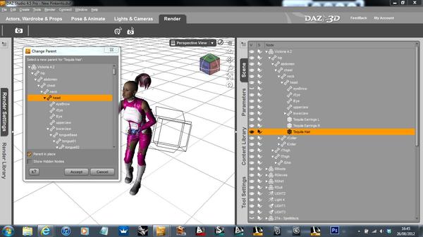

Thank you, but I have done that and still no chance?
Your figure must be in the Zero position before you Parent.
P.S. Your list should read
Head
Hair
Ear Ring
Ear Ring
ect..
You want your props just under Head, nothing lower. Just move the name. it will drag.
To Zero your figure Select it then open the Parameters Tab find that little four line MENU open it and select Zero then Figure.

HR2 hair as you found has no "Fit To" command. CR2 based hair props do.
As far as I am aware it should folllow V4.2 if you had V4.2 selected before loading the Hair on to the figure. You shouldn't have to parent the hair prop manually as it should parent to V4.2 on loading but only if yiu have V4.2 selected first.
Too Add: This is what the product page http://www.daz3d.com/shop/tequila-hair says
"Tequila Hair comes as a hair prop that fits Victoria 4 by default, but is also including thirteen morphs to fit it to other figures"
