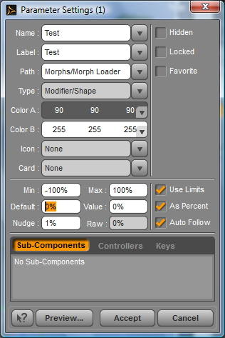

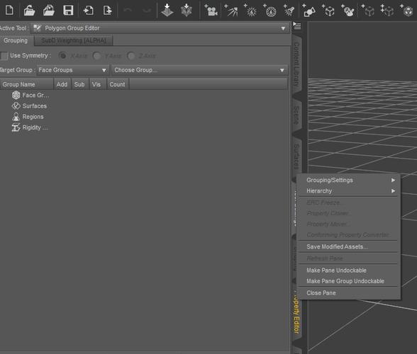

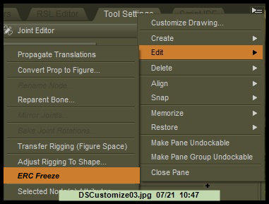

    ERC-Freeze in Parameters tab edit-mode
    You can access the ERC-Freeze command in the "Parameters" tab if you change to "Edit Mode" in the right-click menu. Then if you right-click on any property in "Parameters" tab the menu shows many other useful commands and you can see the "ERC-Freeze" in there.
    ERC-Bake in Property Hierarchy tab
    ERC-Bake is the opposite of ERC-Freeze I do know now thanks to "Richard". This means if some values of some properties once ERC-Freeze'd as "sub-components" to a new property this process can be reversed by using ERC-Bake that can be found in the right-click menu of that new property in the Property Hierarchy tab - so the "sub-components" gets deleted from that new property and become "currently used" property values again.
    <quote> ERC-Freeze / Property Hierarchy / merge property Sub-Components </quote> @ http://www.daz3d.com/forums/discussion/60987/erc-freeze-property-hierarchy-merge-property-sub-components
    In the Property Hierarchy pane right-click a property entry with sub-components and choose "ERC Bake ( ERCDeltaAdd )“ in the menu will delete all the sub-components of that property and make them "curently used“ property values again in parameters pane (unfreeze) so they are easily editable there and can be ERC-freezed later. If done with more than one controll property all the sub-components these are now "curently used“ can be combined with ERC-Freeze to a new property.
    create a new property for ERC-Freeze
    To store the property values you have recently changed with ERC-Freeze command you can right-click somewhere in "Parameters Tab" and in the "Edit Mode" menu choose "create new property" for your figure/object in the scene to store the current state of your figure/object to this new property slider with ERC-Freeze - or you can use it on an existing property to add a list of changed values to that property.

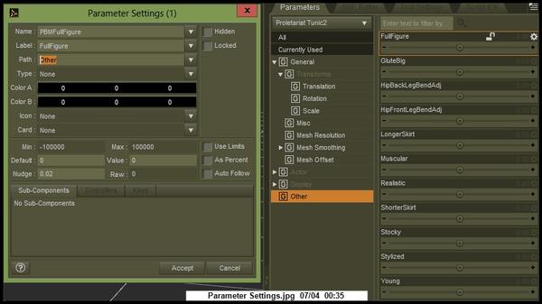

    Choose the right property-data-type ("float" in most cases), a meaningfull name/label and the right place/path in properties group for your new property so its easier to find later and - if made public - others can guess what it does. Also set the property to some special type (other than "none") in "Persentation Attributes" of the "Create New Property" dialoge can help later for example if you set the property type to "Modifier/Pose" this property value gets set back to default value everytime you use "Restore Figure Pose" / "Restore Item Pose" (this is for poses (rotating bones) / translations/position cahnges of figures/objects AND face expressions - man I would love to have a seperated property type for expressions.
    But dont worry you can change everything about the new property later somewhere else. It is enouth to fill in the name (label gets the same emediately) and click "Create" at first.
    The parameter tab in edit-mode offers many functions to edit the properties (also mass-editing with more than one property selected is possible). I recently foud out how well drag and drop on properties works (if drag&drop fails just select it a second time;) to - for example easily change their property group or even darg&drop properties from "Parameters" tab to "Property Hirarchy" tab. (I explain this workflow later in Property Hirarchy section)
    But until now the new property slider recently created does nothing - you first have to define what it should do. (see how I use ERC-Freeze section below)
    how I save new properties to a figure/object

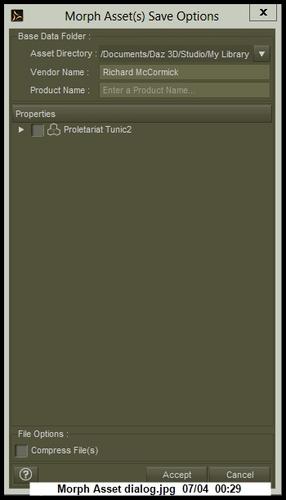

    I have created some morphs/properties for genesis 2 female with "save modified assets" and they have been saved in this folder-path on my harddrive "...\DAZStudio4_Library\data\DAZ 3D\Genesis 2\Female\Morphs\Syrus83227".
    Also the original figure file "Genesis 2 Base Female.duf" gets saved over to write informations so the new property / properties can be loaded with the figure.
    The next time I load a new "genesis 2 female" figure fom the content library into the DazStudio scene my new morphs and properties will be showing up in the "Parameters" tab. Before that they only show up with the figure in my "erc setup scene".
    As you may noticed if you change some property values of some scene objects in "Parameters Tab" the color of the numbers change to bright white. This will show you that the value is not at default state anymore. If you want to get an overview of the properties that are changed to something else than the default value go to "Parameters" tab and click on the special "Currently Used" propertiers group to get the properties listed for the selected figure/object.
    Also every bone value change of the figure rig you do in "Joint-Editor" will show up bright white an can be stored with ERC-Freeze (or memorized to default state - see "memorize figure rigging" in Joint-Editor).
    I found out that "ERC-Freeze" is looking for almost every property of every figure/object that is loaded in the scene and is listing all properties with the changed values in the "Freeze Properties" section of the "ERC Freeze Options" dialogue.
    The first time I decided to try out ERC-freeze the erc-freeze options showed up with a almost endless list of properties I had changed in my scene on diffrent figures and things - while I was at some some frame on the the timeline - I instantly closed it and decided to try it another day.
    So to control what the "Freeze Properties" list will show up next time I have found out you have some options.
    If you want to keep it simple you can create a new scene and load in only the figure(s) / object(s) you want to ERC-freeze properties for - in zero pose and shape. Almost everything you change now will be shown by ERC-freeze next time.
    Or you can select every figure/object in the scene that you dont want to ERC-freeze and use "memorize selected item" for objects and/or "memorize figure" from the main "Edit" menu - or the shorter way "Parameters" tab sub-menu (left-click on the little icon with the triangle and three lines in the left corner).
    The "memorize / restore / zero" functions on figures and objects or only on selected nodes/bodyparts are realy useful while working with erc-freeze because it sets or resets all curently changed property values at the current frame in timeline to default state. So you can store the current values of the properties for your selected figure/object/node with memorize to default state (see "Parameter Settings" min/max/default - value on properties) or reset them back to the default (or currently memorized) state with restore. I also use the timeline keyfames to store snapshots of diffrent property values for my figure/objects in the scene before I use ERC-Freeze on them.
    I usualy dial/load in my character morph on frame one and "memorize figure" there. Then I go to frame two and change the values how I want them to be and store only these settings with erc-freeze to my new property.
    ERC-Freeze Options
    So once I right-click on my new property and choosed "ERC-Freeze " fom the menu I get the "ERC-Freeze Options" dialoge. I cant say much about the upper half of the "ERC-Freeze Options" - wait there is the checkbox "Keyed (Extract from Play Range)" for to ERC-Freeze I would say "non linear" changes over the min/max range of the slider for some property values. With "Keyed (Extract from Play Range)" you can do what it says first set the "Timeline" tab "Range:" to a few frames in between - animate the property changes with a few key-frames and use ERC-Freeze with "Keyed" option to store the value changes as an animation to one property slider but carfull to many "Keyed"-frames will make the preview of property changes lagging - at least by my experience.
    With the "memorize" figure/object method descriped I get only the properties that I want to "freeze" to the new property listed under "Freeze Properties" in the "ERC-Freeze Options" dialoge. Before hiting apply there are just the three check-boxes that I would usualy leave checked.
    And this is it - the next time I change the value of my new property - it hopefully does what it should - and the new shape will fade in. To quickly see what other "sub-component" properties gets changed with some property. I first memorize the figure in zero state and then I set the property value to 1 or 100% or what ever is the maximum and switch the property group to "Currently Used" in "Parameters" tab. If your figure allready has a charcter shape applyed the "Currently Used" list is properbly allready filled with properties with values in white - even if you memorize the figure shape property the "sub-component"s get listed there but not the figure shape "controller" property itself - this is simply because the controller-property gets saved as default value but the affected "sub-component"s default values dont get changed - so keep this in minde while working with ERC-freeze.
    With this method you can easily use erc-freeze in a scene with more than one object/figure with diffrent morph/shapes/poses applyed or even on posed figures "memorize figure pose" or select just some bodyparts and "memorize selected items" on that to store just that bodypart pose at some keyframe on the timeline as default state - so you can decide which current pose / shape to become a part of the new property dial (realy handy for creating your own pose-controlls).
    Property Hirarchy
    If you click on the gear symbol of a property in prameters tab and choose "Parameter Settings" you should see all this name / label / path and values stuff you should allready know about. Beneath that there are the tabs "sub-components" - "controllers" - "keys" for showing any dependencies this property may have. After ERC-freeze'ing something to a new property you will see a list of the "sub-components" in there.
    But if you want to go into detail and realy want to see of what "sub-components" the property is made of - and get a better undersatnding of what the dependencies between some properties are - you should use the Property Hirarchie tab. I recently found out that I just have to customize my DazStudio Workspace Layout and now I have my parameters tab and my property hirarchy tab side by side and can drag&drop some properties around to easily create new ERC dependencies between them. I dont want to explain all this - ERC Add/Substract / Multiply/Divide on Sub-Components and Controllers - stuff here maybe someone else with more knowledge about that could do it in detail here - I think many people including me would appreciate it.
    I am currently just experimenting with this by linking pose-controlls for head-neck and eyes-up-down together and use it side by side with the eyes "point at" null-target funktion.
    see Precise Eye - Point At Null-Target / LookAt-PoseControl with EyeTarget... (have a look its a freebie - with many pictures for description - also with details about ERC dependencies)
    http://www.daz3d.com/forums/discussion/63797/precise-eye-point-at-null-target-lookat-posecontrol-with-eyetarget-fieldofview-direction-obj
    I hope this will reveal some of the mystery of the whole concept behinde ERC-Freeze - that I start enjoy to work with lately. Thanks Daz for this nice and free program.

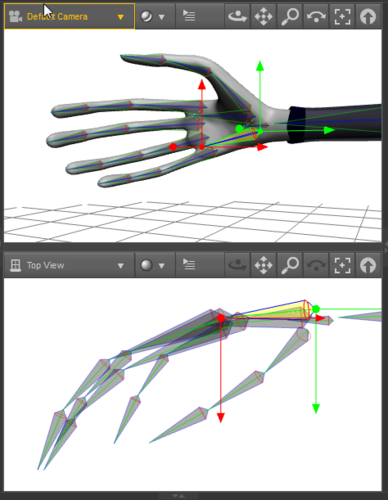

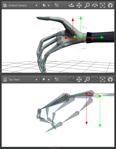

  • One thing I've had troouble with with several different morphs I've done is this: the morph appears to be created properly, but when applied to the base it's designed for (Genesis or Gensis 3 Female in the two specific cases I'm thinking of) when applied to the character, it causes poses and such to end up out of position, meaning that the resulting morphed character moves when the pose is applied. How do I fix that?
  • gypsyangelgypsyangel Posts: 1,010

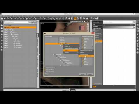

    For starters, make sure the model you export is in a zero position. You can try adjust rigging to shape. That covers a multitude of sins.
  • I think I figured it out, actually. Never test it in the same scene file that you developed the initial morph in; it tends to goof things up if you do, from the looks of things.
    Sounds like a scaling issue of some sort. An example of this is if I export a model at C4D scale and then forget and send it back via goZ. Often this will move the pose lower when the morph is applied.
    Also if your morph is extreme and changes the size of the figure dramatically it can muck up posing...if this was the case unless you have realigned the rigging you would get spaghetti arms. However poses often will be at the wrong level due to the hip being in a different level. When creating my Diva morph I had to adjust poses for this reason.
    What was happening, and it seems to have only been in the files that I had saved with the morph design in them, is that the character position relative to the base plane would actually end up below that plane with the pose applied. I'm not seeing that with a new G3F figure with the morph applied and posed; I do see a few instances where the scale difference seems to cause problems, even though I wouldn't think it would since I did realign the rigging. frown
    The initial problem could just have been applying a new pose on top of an old pose then...this can happen. I normally zero the figure between applying poses.
    All realigning the rigging does is to align the rigging to the new shape. From what I can understand this is to be expected. When it happened with my Diva morph which takes Dawn from full size to child size it was happening that some poses for Dawn when applied would end up above or below where they were meant to be. I actually emailed someone to see if they could help they explained that it was to be expected if the size of the figure had changed. Generally it's only an issue with the y axis, this has led me to believe it's due to the changes in where the hip is sitting. If you look at my diva figure her hip is a lot lower than Dawn's. Poses that didn't move the hip up or down like this one...didn't have any issues. But poses like the kneeling one I had to adjust as she would end up lower down.

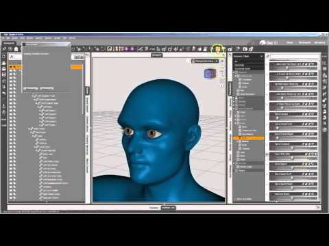

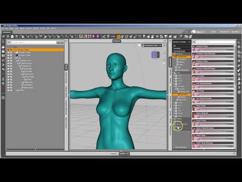

    Cleaning Up Morphing Mistakes by Xenic101 -
    Character Creation Full - Xenic101 -

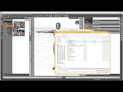

    Using a Mask when Importing Morphs - Xenic101 -
    New Morph Tools Intro - Josh Darling -
    Morph Loader Pro Presets - Josh Darling -
    Introduction To Loading and Saving Morphs - Josh Darling -
