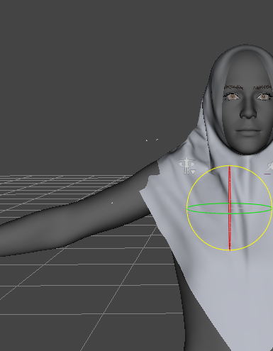

    So I tested using ERC [keyed]
    the result not as I expected.
    The smoothest transition would be using ERC [Delta Add]
    But there's a problem as shown in this pic:
    On the way up the fabric intersects the arm.
    any solution?
    385 x 495 - 73K
    Post edited by James_1597261 on

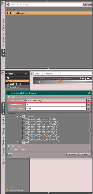

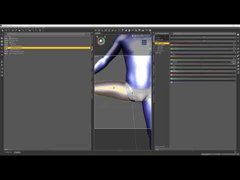

  • crosswindcrosswind Posts: 9,774
    edited August 2023
    There's no really different way to fix corrective morphs on G9's clothing, only the naming convention has been changed from pJCM to CBS. However, I myself have not seen corrective morphs or joint rotation on a garment with manual ERC Freeze, let alone a 'video'. Pls show me some examples...
    The reason why we fix pJCM/CBS on a garment is that the auto triggered corrective morph on the garment is not correct in terms of geometry, then we must save the fixed / imported corrective morphs as morph assets along with the garment (in the data folder of the garment), to override the auto triggered corrective morphs.
    The SS I showed you was done on a G9's base figure according to your '90%'s case' though we normally never do so... well I just showed you the mechanism of ‘Keyed’. 'Keyed' is stronger than Delta Add. You can define various range of values and of course it brings you the smoothest transition with Key Types (TCB/Linear...). It's commonly used in lots of products depending on various conditions of Controlling.
    For such a case on a garment, I'm still not sure why you have to give it a 'threshold' of a certain value or percentage, but technically if you wanna do so, you need to uncheck 'Auto Follow' in its Parameter Settings, then add a Rotation as its Controller and set Keyed range. The mechanism is always the same, just the settings are different.
    as this clip - : https://mega.nz/file/2SI2gBZb#fsGsRorvoL3oNycTvOho65o_zZ6VkbEdXVvNT97BlFc
    Post edited by crosswind on

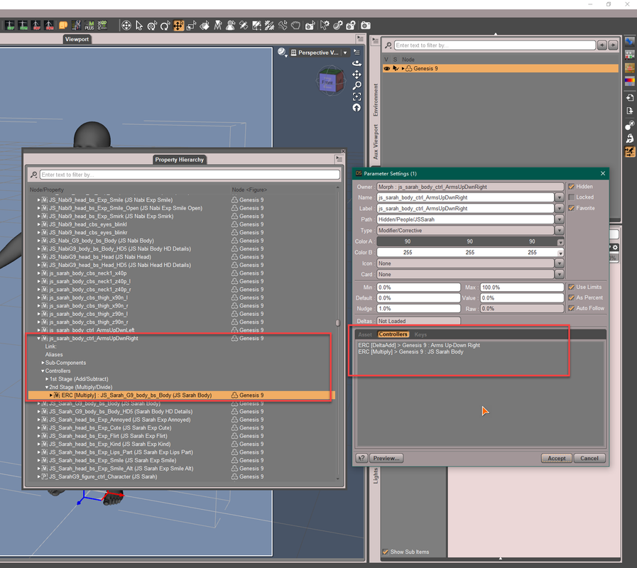

    How to make a JCM only starts to active if none of the shoulder jcms are 0?
  • James_1597261James_1597261 Posts: 1,179
    It seems if I put one shoulder JCM to multiply the other on add/subtrack, it works as intended.
    But... I don't get how this work.
    Sickle Yield showed that in her tutorial above, didn't she?
    edited August 2023
    Sickle Yield methods aren't too good if applied on my case.
    But I did this and perfect:
    I put one shoulder JCM to multiply/divide and the other on add/subtrack,
    then it works as intended.
    But... I don't get it how this work. I was just lucky.
    edited August 2023
    Technically, you may use 2 Stages' conditions but that should depend on your case and controlling logic... 1st Stage is like a main 'trigger', e.g. a Rotation which will activate pJCM / CBS, 2nd Stage is used for 'multiplying' other condition(s) and the value(s) will be multiplied to calculate the value coming from 1st Stage.
    But TBH, as per your case of using 2 'symmetrical' pJCMs as Controllers, one goes to 1st Stage, another goes to 2nd Stage, so their values will be multiplied as the result sent to the 3rd pJCM... the controlling logic seems a bit weird especially when left / right shoulders bend with different degrees... it's still subject to the position of the 3rd pJCM. cool  Anyway, as for 'symmetrical' controllers, suggest use 1st Stage with KEYED while reserving 2nd Stage for other conditions that really need to be 'multiplied'.
    The mechanism and approaches in DS ERC controlling could be flexibly used but better not be misused... especially for making a Product...
