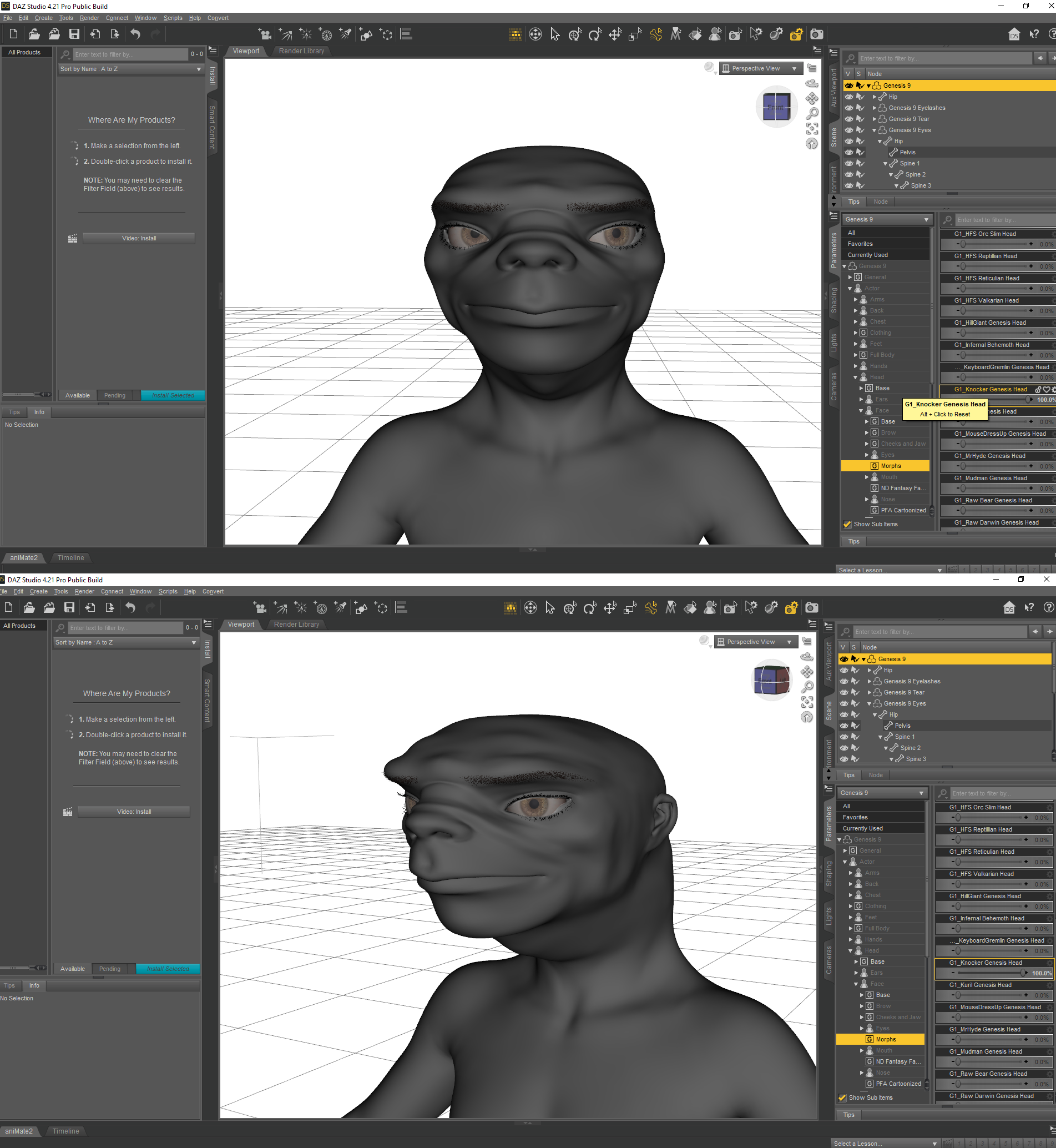

  • Bunyip02Bunyip02 Posts: 9,345
    edited September 2023
    Tried it on the Genesis 1 Knocker figure head, seemed to work okay !
    1903 x 2068 - 705K
    Post edited by Bunyip02 on
