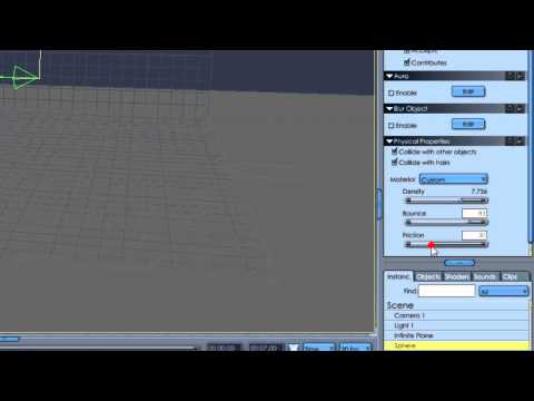

  • DiomedeDiomede Posts: 15,471
    Here is a physics tutorial I haven't seen before.  I am wondering if it has to do with your duplicates.  Did you get a choice to edit the master or create a new master when you set the physics for the first cash pack?
