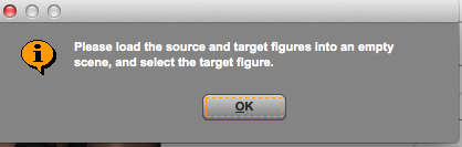

    Apologies for the delay responding, as I've been travelling again. You'll need to load BOTH source and target figures into the scene then select the target figure. See attached screenshot with David and Genesis.
    Make sure you select the whole figure by double-clicking it in the viewport, or selecting it in the scene tab. If you select a body part, PoseMaster won't recognize it as a figure. Note in the screenshot that the Genesis root figure is highlighted in the Scene tab.
    If you do it that way, it should work, otherwise there is something else going on. If you can't get it to work, please post a screenshot so I can see what is going on.

  • inquireinquire Posts: 2,460
    Hi, cridgit: OK, it worked! So, maybe I did something foolish before, eh? That, or, sometimes it seems to me that DS gets a little "confused" if I've been doing various things with it. Maybe it just needed a fresh start. In any case, PoseMaster deserves a great deal of credit. It's a marvelous tool.

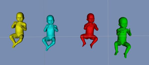

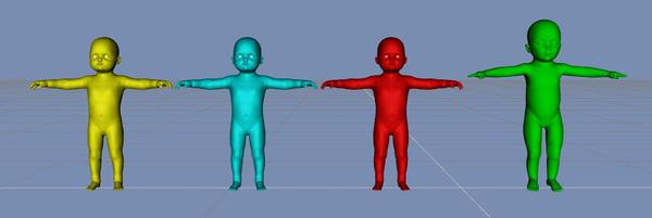

  • scal.64.psscal.64.ps Posts: 140
    edited March 2013

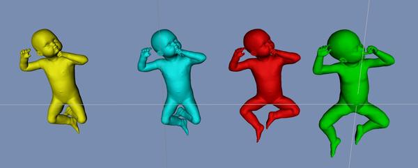

    Thanks Cridgit,
    I followed your instructions and it seems the first result looks pretty nice
    Below are several picts showing 3 GenBabies vs 1 MilBaby3 (wich also make an idea of the height difference).
    1st pict shows our army of babies in the neutral T position
    other picts shows the babies after appying several poses intended for MilBaby3
    on every picture, i applied directly the MB3 pose on the yellow baby ; the transfer pose without the skeleton map on the blue one and finally the transfer pose with the skeleton map on the red one
    results looks quite good on the red one but a real nightmare with the blue (XYZ axis looks scrambled and need to replace the baby in same direction as the 3 others)
    i just noticed some hand and fingers problems with the red one, especially on the pose he's suppose to have the thumb in the mouth
    1272 x 555 - 124K
    1313 x 528 - 158K
    1226 x 411 - 143K
    1266 x 587 - 176K
    Post edited by scal.64.ps on
  • cridgitcridgit Posts: 1,765
