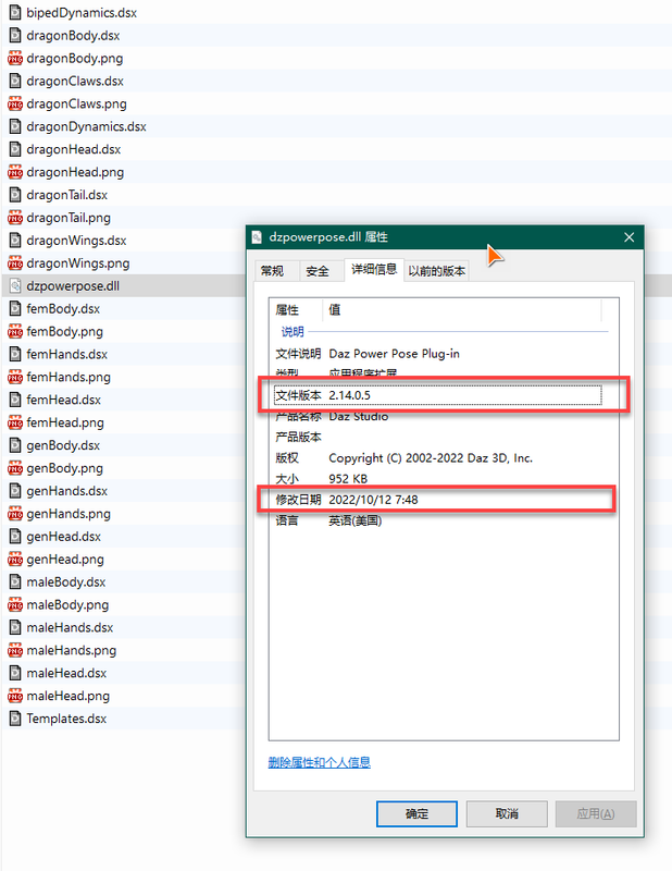

    Let's just help you to try all necessary means... Now, you may go to : C:\Program Files\DAZ 3D\DAZStudio4\plugins, move the file 'dzpowerpose.dll' to somewhere else, then launch Ds, see what happens...

    Ah AH ! Eureka !  I think we found the culprit.
    There is no Dzpowerpose in the .dll list. I think i need one there to fully launch Daz.
    the weird thing is just before the load screen dissapears it does say Powerpose tool..loaded.

    Actually you don't need to paste it to 'upper plugins folder'. As above mentioned, I firstly suggested you 'move out' Dzpowerpose.dll file from that folder, which means DO NOT let DS load PowerPose plugin, see if you can successfully have Ds opened !
    If you can have Ds opened then, the only reason might be: When you upgraded 4.15 to 4.21, 4.15 instance was not fully closed, so the plugins 'dll' files were ocuppied by the application and could not be updated...
    PS: You may right mouse button click on Dzpowerpose.dll file, from the menu - Properties, check its version and updated date, it should be: 2.14.0.5 / Oct 12, 2022
