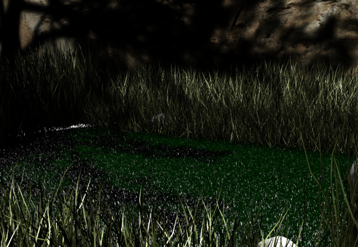

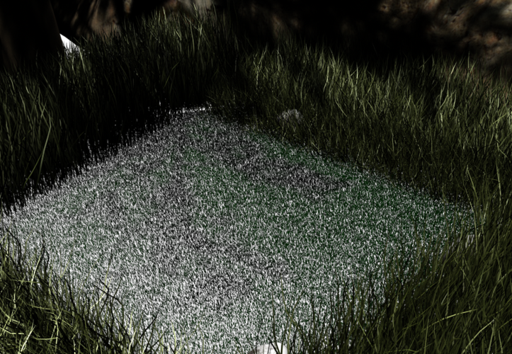

    this is what i get. I also noticed that it hadn't saved a background picture i inserted. Behind the castle, i had imported a picture of a spooky night. In rendering window it was visible. When i saved the photo, it is plain white.
    i am posting two examples and one from the castle (small png). The grass is supposed to be green and behind the castle is supposed to be a beautiful picture background.

    All background Images will dissaper in png's. That will become the Alpha channel when saved. And all areas that are see through will aslo be a clear Alpha channel when saved. Your trouble can be fixed two ways. The easy way, render as JPG. If that's not what you want make Two primitive Planes, position one behind your scene and put the background image on it in the Diffuse channel. Position the other just under your ground prop and change the Diffuse color to what ever helps your render the best, Brown, Green, Black ect.. you might need to test a few before you find what you like. Then render as a PNG.
    Note that it depends which program you're using to view the png. Some will automatically show the alpha channel as transparent, some won't. There should be a setting in your program's options, or an easy on/off switch in the program controls.
