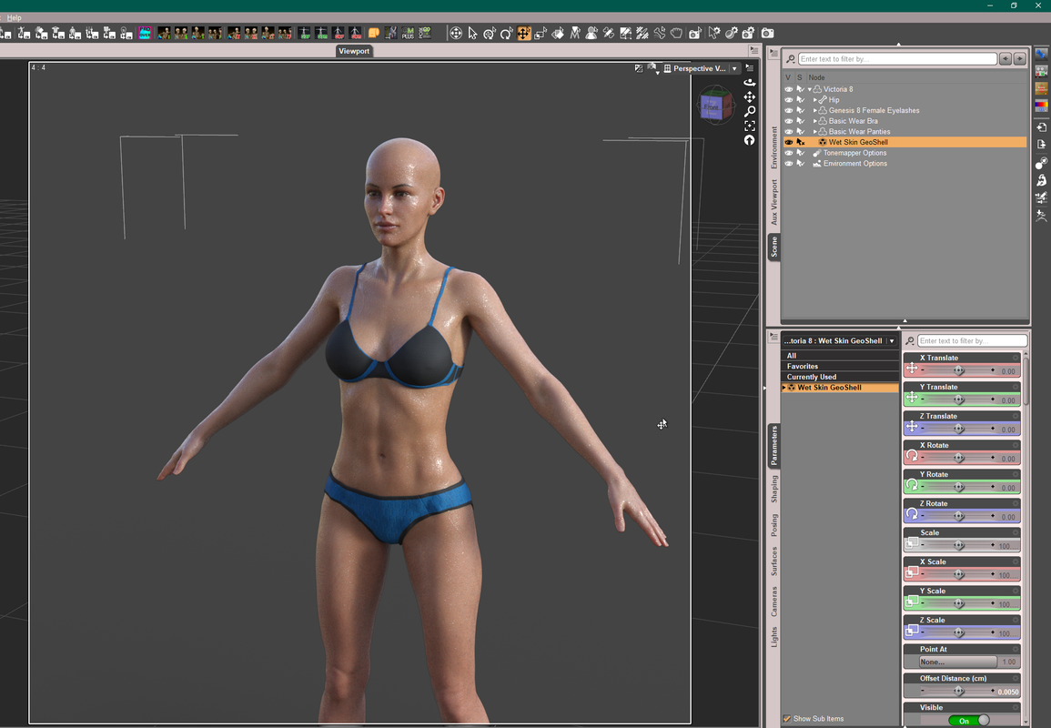

    I've just tested it and haven't seen any poke-thru or problem. Can you post a screenshot?
    Make sure you apply the correct Geoshell for V8 since there‘re 2 geoshells in this Long Wet Hair product - G8F and G8M. Load the shell for G8F...

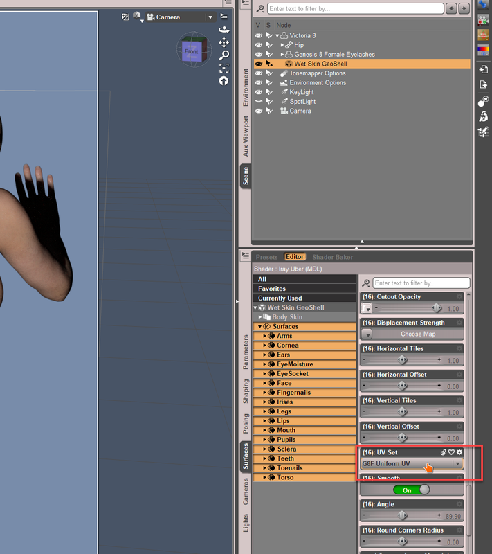

    OK~ It looks like a UV problem. First pls check the UV Set on Geoshell's surfaces... see if it's correct? Should be 'G8F Uniform UV'
    This is the wrong one, more likely as same as your screenshot...

    That did it!

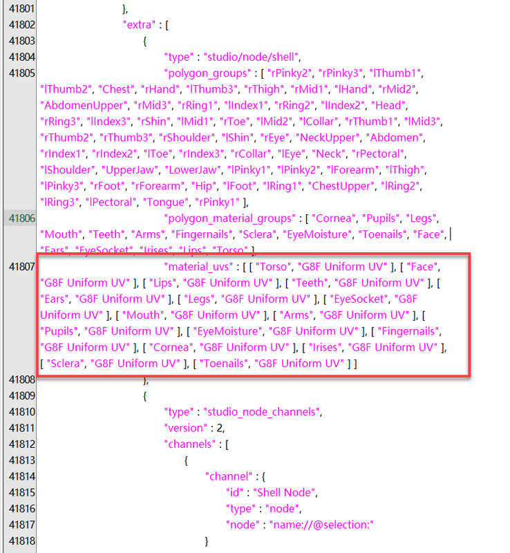

     What I used for testing was just standard V8, nothing was wrong. And I checked the code in geoshell duf file, there's no error in terms of setting UV Set.
    So pls give it more tries ~
