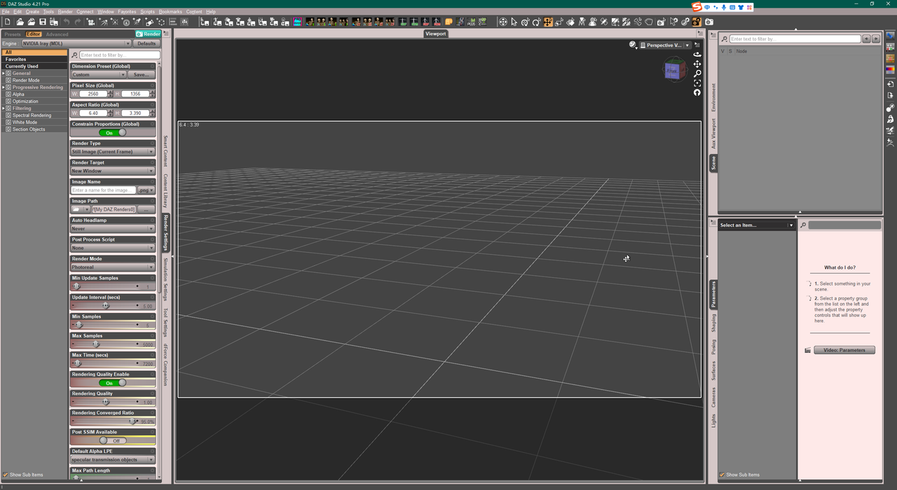

    I cant get it, Im trying to make the dimensions that will fit on a phone, can someone send me or screen shot me the dimensions i need toi put in both the pixel size and tyhe aspect ratio
    i want it like the green box in the first image

  • VicSVicS Posts: 1,273
    I'm trying but it doesnt work, keep getting the same results as the images I sent
    i was using Riversoft's camera cutaway, I just turned it off but same results, even in perspective view, same results

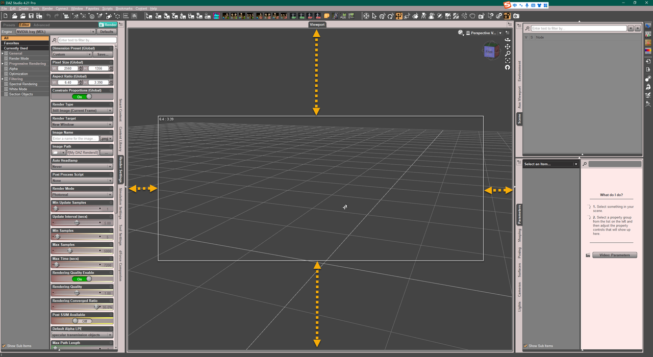

  • crosswindcrosswind Posts: 10,333
    edited April 2023
    Shall we confirm what you want first ~~  More or less the frame below is the proportion of iPhone 12's screen.  The default is like this:
    But you wanna have sth. like this?
    yes Crosswind that is how I'm trying to get it to be
    edited April 2023
    Unfortunately my friend, it is not like what we can make in Photoshop...  As far as I know, we have no way to make it in DS now, since the 'frame' is auto-adaptive to the 'Viewport', by height or width. If there's any solution, I'll be also very happy and highly grateful! laugh
    PS: but still I don't think there's any trouble or problem in terms of manipulation by using current feature..  just keep the right proportion with enough resolution for rendering, that'll be fine.

    No no, he just wanna have these 'margins' (arrows in yellow)... in other words: set the 'frame' right in the center of the viewport with 'margins'...
    edited April 2023
    the frame should automatcially go in the center like that and the dimensions have to be exact so it willfit on the phone screen good

    this seems to be nothing to do with the dimensions of the render but how you want the framing displayed in the viewport which is affected by the layout options you use including tab docking
    Crosswind , 480x800 is the dimensions for a phone animated gif
    davorama thanks for the screenshot-using same dimensions mine still goes all the way to the top
    Wendy can you tell me how to play around with the layout options you use including tab docking but which one of those did davorama use that they got their preview frqame not to go all the way to the top
    and I still thought it should be ceneter3ed as in Crosswind's example-or centering it depends on the dimensions and 800 x 480 will never be in the center screen like that?
    3780 x 2125 - 4M
    1616 x 1469 - 590K
  • VicS, If the end result is that you want an image to be rendered to 800x480, the white box that appears on your screen is the correct proportions, no matter how large or small or what position it may appear on your screen and no matter if there is no gap between the sides of the white box and the edge of the panes. You can drag the edges of the panes from side to side and it will make the panes smaller or larger, however this is not important.  The key is that the white box is proportionally correct and when you click the render button, the image will be rendered in a new popup window at 800x480, it will not be rendered in your preview screen area.  So just make sure that you set the white box size as shown by my and others images and that the area you want to have in your render falls withing the white box, anything outside the white box in the preview screen will not render.

    If you want to see in advance the area that will render, then you need to enable Aspect Ratio in the display (from the hamburger menu at the top of the viewport). Not sure it will show in Filament  Mode, but definitely will in Texture Shaded.

    One obvious question, do you have "Use Local Dimensions" On or Off in the camera you are using?
    If you have it set to On, it will override the render settings
