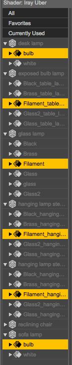

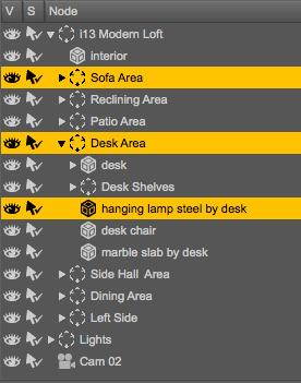

    Rob and I both have scripts with the ability to select by any criteria you would like. The script can select all materials with a particular tag across the entire scene, or it can select only the materials with a tag from selected node(s). I've been testing against i13 Modern Loft since it has heirarchies of both nodes and surfaces. What I wanted to be able to do is select all the "Emissive" materials in a given part of the loft.
    I assume you still want to select by tag. I believe that's more appropriate than selecting by name. That way (using the lighting example) the surface name can be "flame," "filament," or "tube," while the material is tagged "Emissive," or "Light."
    This script traverses the heirarchy of the currently selected nodes and selects all the surfaces with the specificied tag. It also selects the node for the newly selected surface such that the selections are displayed properly in he surface pane.
    If you start off with the scene selected like this,
    then run the script, you end up with your scene like this,
    and your surfaces tab like this.
    Is this what you're after, or something else?

    Yeah from what I can make out I would say that is what I would like very much. Just so we are on the same page the last scripts didn't need anything selected in the scene before hand I assume this will still be the case? if it is then YES your example is ideal.

    OK, I've got two separate scripts:
    SelectSurfacesByTag.dsa
    SelectSurfaceByTagForNodes.dsa
    The first selects all surfaces in the scene with a given tag. The second selects surfaces only from nodes (and their children) that are selected in the scene tab. Both of them display the selected surfaces in the surfaces tab when they're done.

    Esemwy thank you for you efforts that latest Tag script works a treat.
