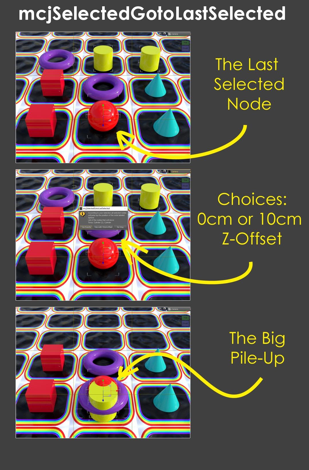

     I quickly wrote mcjSelectedGotoLastSelected a minute ago
    I'll post it in its own forum thread, in case it evolves ( a.k.a. gets complicated )
    so you select all your loaded props copies or instances, the last selected node position is the target position
