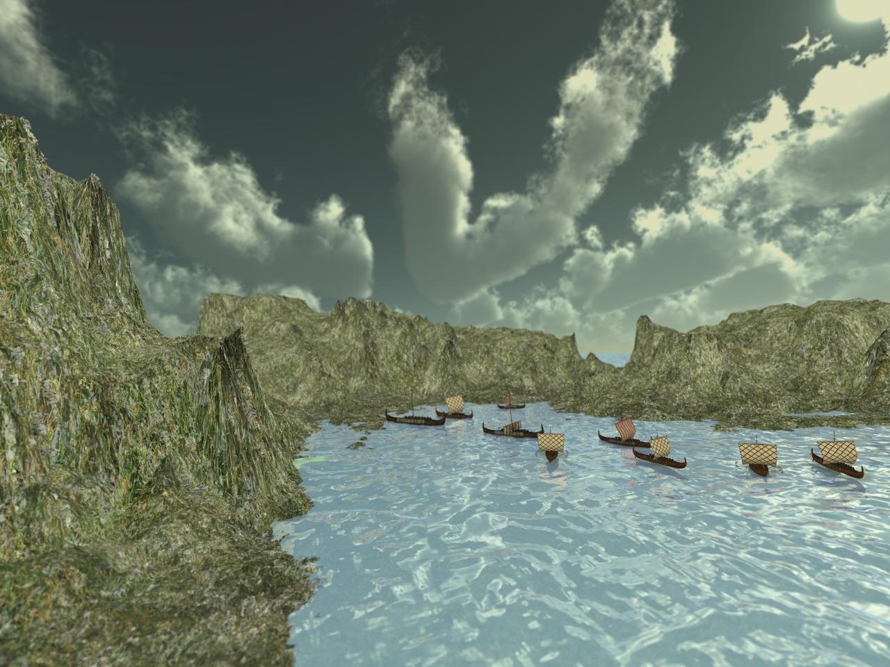

  • FishtalesFishtales Posts: 6,233
    edited September 2015
    I exported this terrain over from Bryce using bridge and used one of the grass shaders on it. I remember I had to increase the tiling on it, or something, to get it smaller so that it didn't look like a thatched roof smiley The original Bryce texture just didn't come across in a usable fashion.
    Click on image for larger size.
    1280 x 960 - 878K
    Post edited by Fishtales on

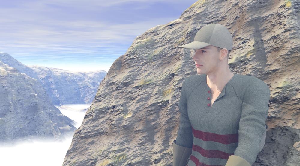

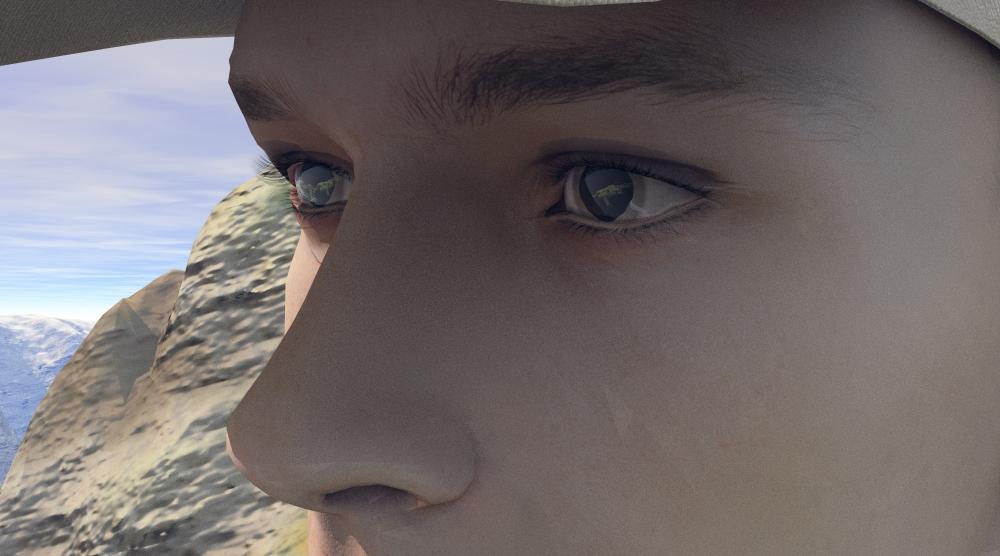

    tring01 said:
    Good glory the landscapes look amazing!  But the human figures look pretty cartoonish.  Can human figures be done photo real in Bryce?
    In what way cartoonish?
    Two of mine done in Bryce.
    Click on image for full size.
    1000 x 556 - 462K
    1000 x 556 - 382K
