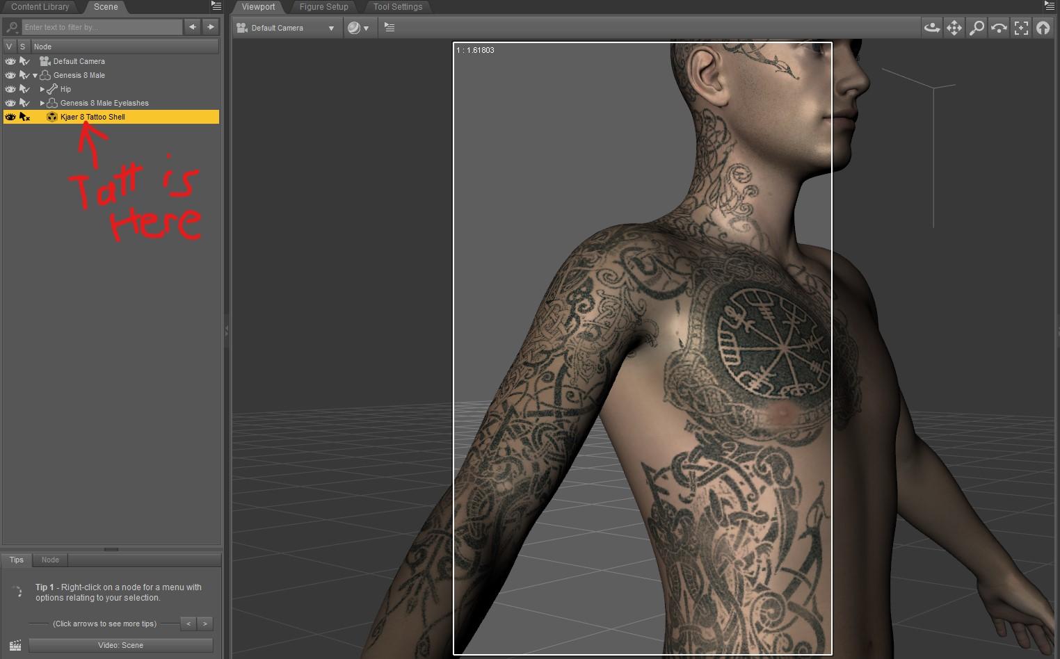

    I'm fairly certain both Freja 8 and Kjaer 8's tattoos were geoshells. It should automatically create the geoshell and apply the tattoo when you click the tattoo preset. Can you post a screeshot of your scene pane with the figure expanded, like this:
    Does it not show up for you like this?

    Indeed~ BTW, like your avatar yes~

    So this is what I see even after I've clicked a tattoo I want to apply, and I'm just not sure how to progress!

    There is a wearable - Freja 8 Tattoo !Geometry Shell in Tattoos folder, load it to Freja 8, then you may apply other tattoo material presets with this shell or Freja 8 selected~
    BTW, there're different types of tattoo in DAZ : tattoo embedded on base material, LIE tattoo, Geoshell tattoo, decal tattoo etc, so the approach of loading them is different...

    I could scream. The file wasn't in my smart content for some reason, but after you said that I did some digging, found it and gave it the right category! Thank you so much!
    I mean I know have the problem of white textures but that's another thing entirely for another day...
    Thank you all for your help!
