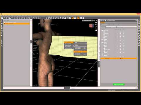

    Rigidity will help if the figures shaping morphs are doing funky things to the item

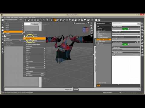

    Smoothing - if you didn't add it in Transfer Utility but now you want to try it, here's how
