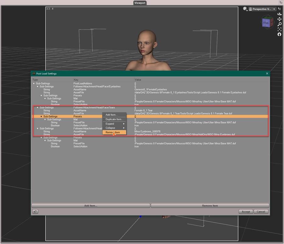

    I used CHB Eden 8.1 as an examle for changing Mina's skin materials and Eyebrows. The settings are shown in the attached screenshots:
    1) Load Eden's skin preset to Mina. Remove Mina's eyebrows and add Eden's, plus eyebrows material;

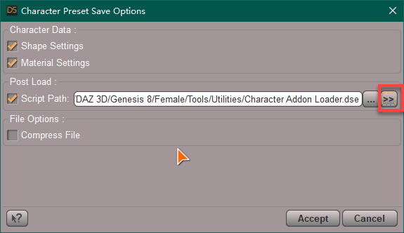

    2) Save Character Preset.. Open Post Load settings:
    3) Firstly delete the Preset subsettings of Tears:

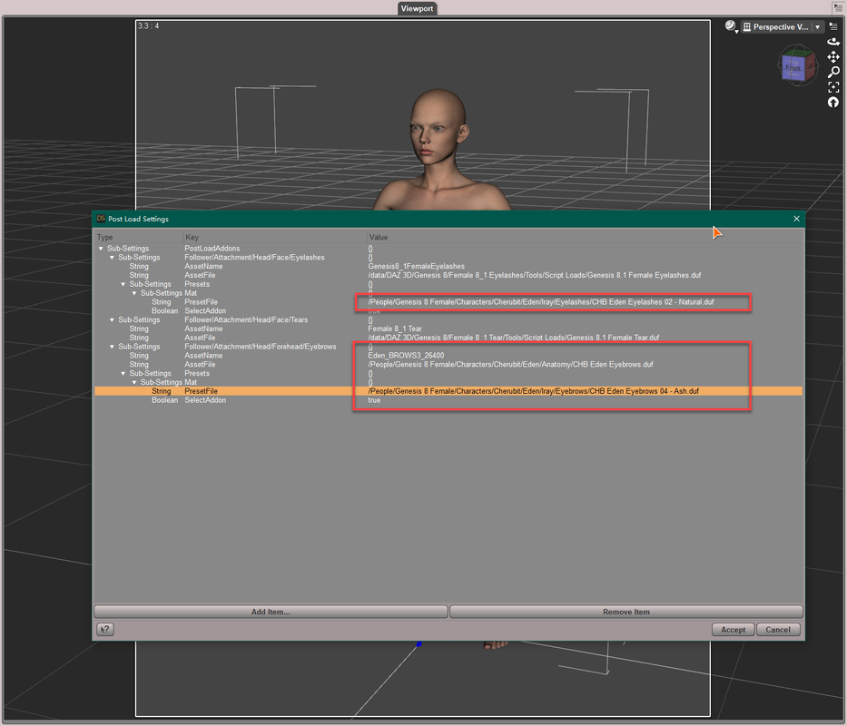

    4) Change settings of Eyelashes and Brows to Eden's:
    You have to manually paste Eden's eyebrows' AssetName (Eden_BROWS3_26400) to the String. It could be found in Eyebrow's Scene Identification.
    Save and load Character Preset. Done~
